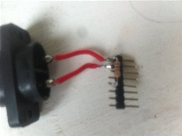

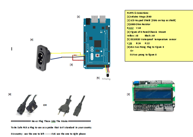

The NEW Pinout:
Save some wire and solder the divider onto a pin header

    Parts:
    -Arduino - Uno/Mega
    -Standard American two prong plug
    -1 kohm resistor
    -DS18B20 Waterproof Temperature Sensor
