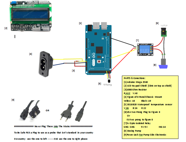

This Blog is about making a nutrient dosing system for hydroponics that is plug and play, I didnt quite get it to the full stage of plug and play with this version. But it is almost there. Because the change of nutrient strength of our systems can be modelled as a linear system with respect to nutrient delivery it should be possible to implement a very simple self tuning control system based on the system model. Why a Self Learning system:
>System only needs to be roughly defined
>Adapt for pump wear
>Adapt for a change in nutrient source strength
>Plug and Play for a wide variate of Systems
>No problem dealing with the Lag between delivery and stable reading
I made this control system with Urine as a nutrient source and because the concentration of urine can vary we need a system that can take this into account. A traditional PID controller will struggle here [Or at least I would struggle to implement a good one] because of the large lag between input and output measurement due to the mixing of nutrients in the system [Tank mixing+Grow beds fill+drain time]. It will also work for traditional liquid fertalizer.

Main Variables in the script
>Tank size in L
>Nutient Strength [Stick with 100 or follow hints in the code]
>Pump Size [L.Second-1]
Variables input by LCD Screen:
>EC Set point
>Probe Calibration
The only real choices hardware wise:
Pump sizing
Although this is a self learning system we still need to choose a nutrient pump of a suitable size so the pumping interval is quite large to reduce the effect of pump priming and post pumping discharge [Fancy words for the pump acts weirdly when we first turn it on and just after we turn it off].
I have not included the maths here to fine tune your pump size because it doesnt matter that much, just pick a pump with a flow rate of less than 10% of your main tank volume per minute.
The Pinout:
