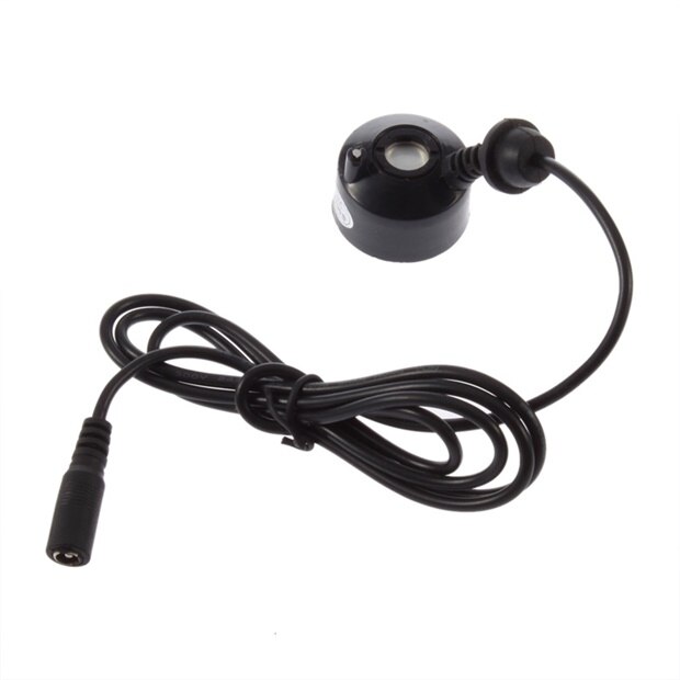

>24v Ultrasonic Mister [£2]
[You may want multiple units for large rooms/ large amounts of mist]

Misters have a female 5.5mm Power jack [common size for wall mounted power supplies]

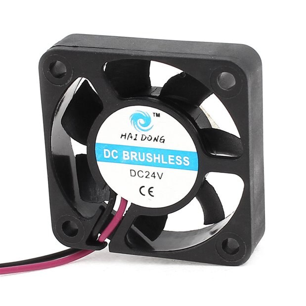

>24v PC Fan £1

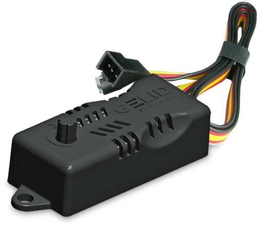

>Fan Speed Controller [Optional] £2
The basic ones just work as a voltage divider, so you can make your own from a potentiometer if you like.

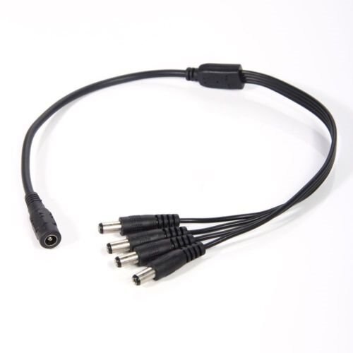

>5.5mm 12v splitter cable [Optional] £2

>Cut 4 holes in the top of the container you plan to use, two the size of the fan you selected and two smaller ones for the waterproof bungs on the mister wires.
>Mount the fan so it is blowing air into the container [stops the motor getting wet] and alter the mister lead length in the bungs to place them in the middle of the container away from your inlet and exhaust holes.
