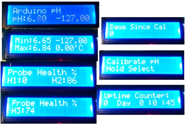

The LCD has a few useful Screens

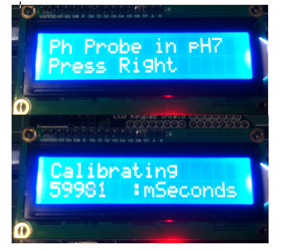

The LCD GUI will guide you thru a Calibration process:
Probe Life
The LCD screen with Probe life should have all readings above 50% to be considered a probe in good health, if ones lower I recommend cleaning it or ordering a replacement [It will fail soon].
There are three indicators of probe life when we calibrate.
http://reagecon.com/pdf/technicalpapers/Electrode_CM_v5_TSP-02_Issue_4.pdf
In the Code these are showed as:
H1: pH7 offset [pH7 should output the ideal voltage of 1.96, as they age they get an offset
H2 Slope,  change in mv between pH4 calibration and pH7
H3:Drift , Healthy probes should have reached a s.s value after 60 seconds, this one checks for a difference between a reading at 60 seconds and 120

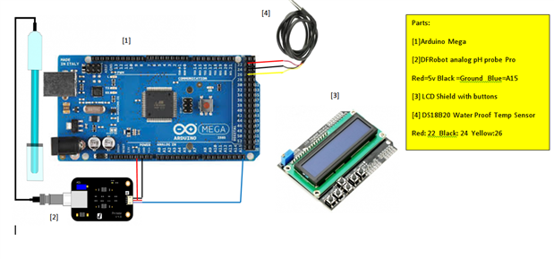

    Parts:
    -Arduino - Uno/Mega
   -df Robot Ph Probe Kit [SKU:SEN0169] This is a great PH sensor compared to the ones ive had in the past
    See www.MichaelRatcliffe.com/Projects for a Pinout and user guide or consult the Zip you got this code from

void CalibratePH(){
//we check if we are on ph screen and the select button is held
if(Screen!=4) return;
if(button!=5) return;
else delay(1000);
read_LCD_buttons();
//we need to stop in this loop while the user calibrates
while(1){
read_LCD_buttons();
lcd.setCursor(0,0);
lcd.print("Ph Probe in pH7   ");
lcd.setCursor(0,1);
lcd.print("Press Right            ");
//user pressed right?
if(button==1) break;
delay(100);
StartCalibration1=millis();
//We are giving the probe 1 minute to settle
while(millis()<StartCalibration1+60000){
lcd.setCursor(0,0);
lcd.print("Calibrating              ");
lcd.setCursor(0,1);
lcd.print("                      ");
lcd.setCursor(0,1);
lcd.print(StartCalibration1+60000-millis());
lcd.setCursor(7,1);
lcd.print(":mSeconds");
delay(1000);
ReadPH();
delay(100);
ReadPH();
   //*******Saving the new value to EEprom**********//
   mvReading_7=mvReading;
while (1) { // wee need to keep this function running until user opts out with return function
  read_LCD_buttons();
  if(button==3) return; //exits the loop without saving becauser user asked so
if(millis()%4000>=2000){
     lcd.setCursor(0,0);
     lcd.print("Calibrated         ");
       lcd.setCursor(0,1);
      lcd.print("Select To Save       ");
else{
      lcd.setCursor(0,1);
      lcd.print("Down to Exit           ");
   if (button==5) break;
//read the ph probe
   //Saving the value steight from ADC, removes conversion errors
   value= average/4;
   EEPROM.write(addresCalibrationPH7,value);
   //Resetting the days sinc calibration
   Days_Since_Calibration=0;
   CalibrationWarning=0;
   Slope_calc();
   ProbeLife_Check_1();
   EEPROM.write(addresseCalibrationDays,Days_Since_Calibration);
   //Displaying the new offset
   lcd.setCursor(0,0);
   lcd.print("Saved Calibration        ");
   lcd.setCursor(0,1);
   lcd.print("Offset                        ");
   lcd.setCursor(3,1);
   lcd.print(offset);
   delay(2000);
   //move onto pH4 Calibration
   lcd.setCursor(0,0);
   lcd.print("Rinse and           ");
   lcd.setCursor(0,1);
   lcd.print("Placein pH4                      ");
   delay(4000);
   while(1){
   lcd.setCursor(0,0);
   lcd.setCursor(0,1);
   lcd.print("If Probe in 4                       ");
   //move onto next stage if select is held
   read_LCD_buttons();
   if (button==1) break;
lcd.setCursor(0,0);
lcd.setCursor(0,1);
lcd.print("                      ");
lcd.setCursor(0,1);
lcd.setCursor(7,1);
delay(1000);
ReadPH();
delay(100);
ReadPH();
mvReading_4=mvReading;
  while(millis()<=StartCalibration1+60000){
  lcd.setCursor(0,0);
  lcd.print("Health Check              ");
  lcd.setCursor(0,1);
  lcd.print("                      ");
  lcd.setCursor(0,1);
lcd.setCursor(7,1);
  delay(1000);
ReadPH();
delay(100);
   ReadPH();
   mvReading_4_Delayed=mvReading;
   //Saving ADc readout, to remove conversion errors
   value= average/4;
EEPROM.write(addresCalibrationPH4,value);
   Slope_calc();
   ProbeLife_Check_2();
   ProbeLife_Check_3();
   //Put back to main screen and exit calibration
   lcd.setCursor(0,0);
   delay(1000);
  //Informing the use about the probe life
while(1){
read_LCD_buttons();
if(ProbeLife2>=50 && ProbeLife2>=50 &&ProbeLife3>=50){
lcd.setCursor(0,0);
lcd.print("Probe Condition  ");
lcd.setCursor(0,1);
lcd.print("Good            "); }
if(ProbeLife2<50 || ProbeLife2<50 || ProbeLife3<50){
lcd.setCursor(0,0);
lcd.setCursor(0,1);
lcd.print("Faulty           "); }
if(millis()%6000 <=3000){
lcd.setCursor(0,0);
lcd.setCursor(0,1);
lcd.print("To exit               ");
delay(100);
   Screen=1;
   return;

                                      //** First Screen Shows Temp and EC **//
                                      if(Screen==1){
                                      lcd.setCursor(0,0);
                                      lcd.print("Arduino pH   ");
                                      lcd.setCursor(0,1);
                                      lcd.print("pH:               ");
                                      lcd.setCursor(3,1);
                                      lcd.print(phValue);
                                      lcd.setCursor(9,1);
                                      lcd.print(Temperature);
                                      lcd.print("'C");
                                       //**Third Screen Shows Min and Max **//
                                       else if(Screen==2){
                                      lcd.setCursor(0,0);
                                      lcd.print("Min:              ");
                                       lcd.setCursor(4,0);
                                       lcd.print(MinPH);
                                       lcd.setCursor(9,0);
                                      lcd.print(MinT);
                                      lcd.print("'C");
                                      lcd.setCursor(0,1);
                                      lcd.print("Max:               ");
                                      lcd.setCursor(4,1);
                                      lcd.print(MaxPH);
                                      lcd.setCursor(9,1);
                                      lcd.print(MaxT);
                                      lcd.print("'C");
                                      else if(Screen==6){
                                      lcd.setCursor(0,0);
                                      lcd.print("Uptime Counter:              ");
                                      lcd.setCursor(0,1);
                                      lcd.print("                                     ");//Clearing LCD
                                      lcd.setCursor(0,1);
                                      lcd.print(Day);
                                      lcd.setCursor(3,1);
                                      lcd.print("Day");
                                      lcd.setCursor(8,1);
                                      lcd.print(Hour);
                                      lcd.setCursor(10,1);
                                      lcd.print(":");
                                      lcd.setCursor(11,1);
                                      lcd.print(Minute);
                                      lcd.setCursor(13,1);
                                      lcd.print(":");
                                      lcd.setCursor(14,1);
                                      lcd.print(Second);
                                      else if(Screen==4){
                                      lcd.setCursor(0,0);
                                      lcd.print("Calibrate pH          ");
                                      lcd.setCursor(0,1);
                                      lcd.print("Hold Select            ");
                                      else if(Screen==3){
                                      lcd.setCursor(0,0);
                                      lcd.print("Probe Health %          ");
                                      lcd.setCursor(0,1);
                                      lcd.print("H1:                     ");
                                      lcd.setCursor(3,1);
                                      lcd.print(ProbeLife1);
                                      lcd.setCursor(9,1);
                                      lcd.print("H2:");
                                      lcd.setCursor(12,1);
                                      lcd.print(ProbeLife2);
                                      if(millis()%6000<3000){
                                      lcd.setCursor(0,1);
                                      lcd.print("H3:                ");
                                      lcd.setCursor(3,1);
                                      lcd.print(ProbeLife3);
                                      else if(Screen==5){
                                      lcd.setCursor(0,0);
                                      lcd.print("Days Since Cal         ");
                                      lcd.setCursor(0,1);
                                      lcd.print("                       ");
                                      lcd.setCursor(0,1);
                                      lcd.print(Days_Since_Calibration);
   if((millis()%10000<=2000) && (CalibrationWarning==1)){
                                      lcd.setCursor(0,0);
                                      lcd.print("Calibrate the          ");
                                      lcd.setCursor(0,1);
                                      lcd.print("Probe                   ");

    The sensor connections are : 22,24 and 26. However in the program lines you mention as comment :  Arduino 9,8 and 10
    Do I have to connect the DS18B20 wires to 22,24 and 26? If yes, do you have any tip for me to get the temp sensor working?
