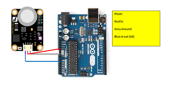

It has been a busy week with Halloween and some unforeseen breakdowns on the farm. we will be catching up on a slow week today.
CO2 is an important factor in plant growth, in some instances sealed grow rooms run at a artificiality elevated CO2 concentration. We wont be doing this in the greenhouse but it would be nice to have a fully defined set of growing conditions for comparing experiments.
DfRobot have been kind enough to send me out a PH sensor and CO2 sensor to keep the project moving along quickly, so we will be using the parts from them:
CO2 Sensor (Arduino compatible)
[You can most likely source the parts from elsewhere]
I will wire the sensor up and talk about how it performs in the next blog on CO2, I think we need to find a cheap way to calibrate the sensors as not everyone is going to have access to CO2 calibration gases [I certainly dont]. Looking at the spec sheet[for the MG811] it might not need calibration, a real life test will be needed to confirm this.
Wiring diagram:
Header 1
   CO2 Sensor Gas:
This script allows you to use a analog c02 gas sensor [like the one in the link below]:
http://www.dfrobot.com/index.php?route=product/product&product_id=1023&search=co2&description=true#.VjeKyXzhDVM
Procedure:
>warm sensor up and take a reading of two known c02 solutions  [note down ADC readout and c02 ppm]
>plug the numbers into the top of the code [Lines 28-31]
>see if it works with a amonia solution between the min and max you calibrated with.
other info:
>Burn Sensor in for a hour or so before stable readings will be had
>Sensor needs time to warm up after being powered up

int GasPin=A0;
float CO2MinADC=0;
float CO2MaxADC=0;
float CO2MinPPM=0;
float CO2MaxPPM=0;
//We will proberbly have to correct for temperature in the long run [not used yet]
float Temperature=0;
float Temp_Coef=0;
float Offset=0;
//[Im guessing it will be liner with a offset]
int i=0;
int SensorBuffer=0;
float CO2PPM=0;
float Gas_Readout=0; //Float incase we attempt to change ADC to PPM
// ************************ Setup Routine ********************************//
void setup() {
  Serial.begin(9600);// turn serial coms on for sending data to pc
  Setup_Info();
//************************** Main Loop ***********************************//
void loop() {
      //Taking ten readings and averaging for accuracy
      i=1;
      SensorBuffer=0;
      while(i<=10){
      Gas_Readout= analogRead(GasPin);
      SensorBuffer=SensorBuffer+Gas_Readout;
      delay(50);
      i++;
      Gas_Readout=SensorBuffer/i;  // cheack that my maths is correct her, I usssualy *** up this bit by one iteration
Map_Results();
Print_Results();
//*************** Printing dome useful info to seerial on boot up *********//
void Setup_Info(){
Serial.println("This script is a proof of concept that we can get useful representation of amonia in water by measuring its gas off");
Serial.println("Gas Sensor needs burning in before first use [30 mins minimum]");
Serial.println("Calibrate, take ADC read out at MAX CO2 and Min and put them in the top od code");
//****************Maps Results after we have Calibration values************//
void Map_Results(){
// Map only gives integers, we will need to modify to get better readings  [thats what all the *100 are about
CO2PPM = map(Gas_Readout*100, CO2MinADC*100, CO2MaxADC*100, CO2MinPPM*100, CO2MaxPPM*100);
CO2PPM=CO2PPM/100;
//********************Print something useful to Serial here****************//
void Print_Results(){
Serial.println("NEW RESULTS ");
Serial.print("ADC Gas Sensor: ");
Serial.println(Gas_Readout);
Serial.print("Amonia PPM: ");
Serial.println(CO2PPM);

    m.ratcliffe over 10 years ago in reply to DAB
    Hey Dab, I haven't got the sensor to test with yet, so cant say about the sensitivity until a later date.
    But I plan on logging the data from every sensor in the greenhouse for the whole main grow[still deciding if it should be local or web based]. The grow room is around 36m^3 with good air movement, so it has a lot air mass to make readings less noisy [I hope].
    DAB over 10 years ago
    Nice update.
    Are you going to show some of the data you collect?
    I am curious on how sensitive the sensor is given your small growing space.
