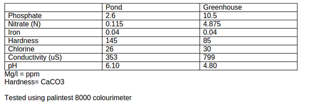

I was unable to have a full spectrum carried out on the proof of concept human urine test and lacked a decent standard I could compare too, but here are some basic measurements compared to a natural healthy pond:
There is little concrete data I can pull from these readings apart from:
>I really need to keep a closer eye on the PH of my system [looks like yet another broken probe, these things are making me poor]
>The carbon water Filter is working well and stopping chlorine from entering the system
