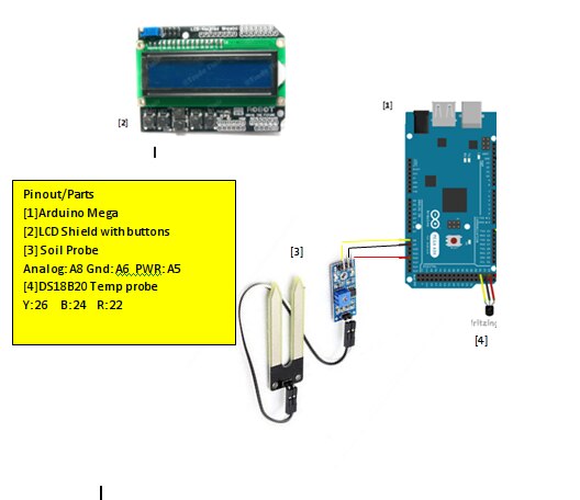

So far we have covered aquaponics/Hydroponics automation and control, we also have a soil based system to use as a comparison.
It is best if we automate this system too, Just so we have an accurate measurement of water used and the moisture level of the soil during the grow.
Probe Choices:
There are two main types of probes on the market for a reasonable price:
>Capacitive sensors [long lasting]
>Resistive Sensors [Cheap, but degrade]
This script will work for both types of probes.
[My probe draws a max of 35ma, that is very close to the arduino 40ma max rating, check yours does not exceed this on the spec sheet]
The pinout:
[note mistake on pinout for probe, Should be Analog:A8 Ground:A9  Power A12]
How to use:
>Wire up following pinout as a guide [moisture sensor can change, so use the pin descriptions on the board. you want to use analog output not digital]
>Place soil and temperature sensor in very dry soil [very dry!] click up on the lvd buttons and make a note of the ADC readout
>On same ADC readout, soak the soil with water and make a not of the ADC readout
>Plug these ADC values into the top of the code and reload to the board
>Thats it, leave the probe in the soil for as long as you like to log data about the soil [min/max temperature and moisture levels]
