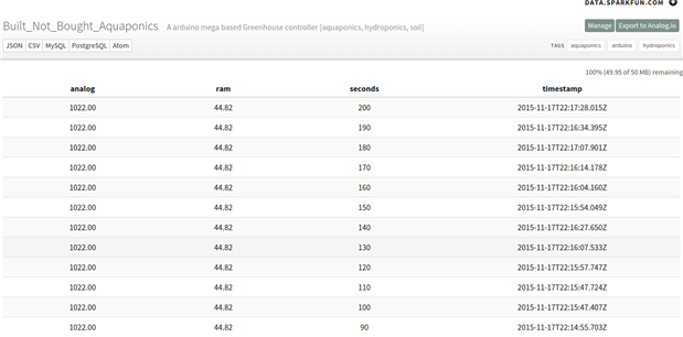

Here is a quick view of what it looks like
Even better you can make your data public, that way anyone can pull a copy of the data while you have a separate key for editing the data.
So Drop a link like this to your project:  https://data.sparkfun.com/adapted_greenhouse

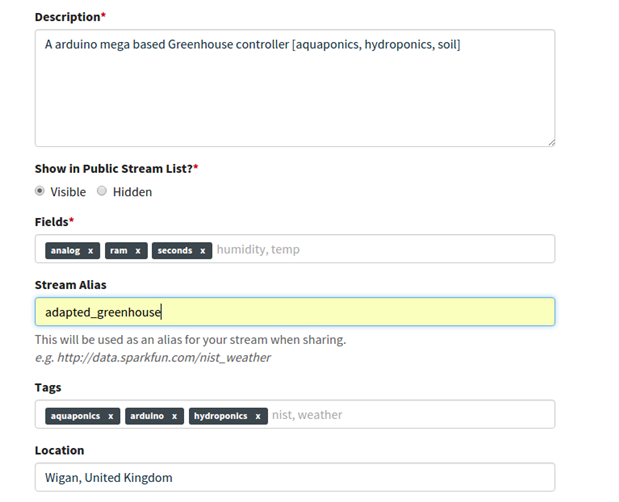

Setting up your free account
Go to https://data.sparkfun.com/
Click on the links to set up your data stream
Make a note of your public key and private key [you will understand when you make an account]
Set up what data fields you want to send, no caps and keep an eye on spelling]
Adapt the code below by plugging in your public and private key and the number of data points you want to log [rember the website and your code must match]
Limitations:
>300 data strings per 15 minutes [Much more than we need]
>50mb limit then it will start to write over the oldest data
<If you need to add extra data points for logging you will need to delete your current log, I recommend adding one or two extra empty columns for any extra data as your project develops.
These are maximum limits imposed by sparkfun, not bad for free!
Here is a screen shot of how the spark fun account should be set up for the code below:
[You will need to put your own alias, I will be keeping hold of adapted_greenhouse]

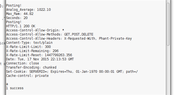

It would be hard to debug this code as there are many areas for failure, I recommend trying these steps if you have a problem:
>Upload WebServer script [its in the arduino IDE examples] see that you can access the arduino via its ip address
>Check you have the same number of columns in your data.sparkfun page as you do in your arduino code, same order, same spelling no caps.
>Make sure you are not sending updates too often to sparkfun, they limit you to 300 per 15 minutes
>Open Serial for more info, below is a screenshot from a good upload
