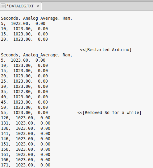

A Example of SD-Card Log
The logging system works just as we expected, and adding a SD.begin before every write means we dont have to reboot every time we remove the sd card for backup. You can import the text file into Exel by special pasting and using commas as cell breaks.

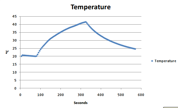

Here is a plot for the same code, logging temperature near my PC fan as it warms up before removing it to cool:
