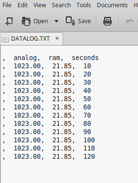

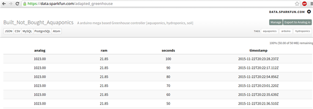

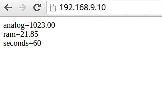

The Previose blogs  showed how to log data in seperate ways.
Blog:18.1 - On-line Data Logging [data.sparkfun]
Blog:18.2 - Data Logging: SD Card
Blog:18.3 - On line data Viewer [arduino, Ethernet]
It will be useful to have all three methods implemented on the same board, this is a bit tricky because we need to power up the sd card to load data, then configure the data.sparkfun push the data and leave the web_server script running until the next sd and sparkfun log. It is a bit messy but possible to do it this way. The screen shots are from the code below.
The Web_Page
Data.Sparkfun
SD_LOG
The Code
Dont use on Uno [very little memory left]
You will need to change the settings in each function [we cant just declare them at the top when running the ethernet this way]
Header 1
This script measures the enviroment withing a greenhouse
Sends data to SD Card, data.sparkfun and hosts a webpage all in the same script. We cannot use the conventional areduino script of definitions so you will have to alter the mac adress ip etc in the functions below the code.
DONT USE ON UNO: This takes quite a lot of emory and could brick your uno, mega is fine because it has much more memory
