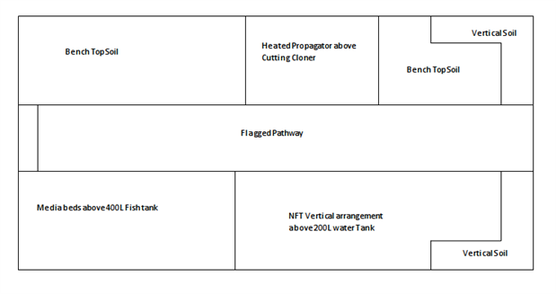

Hello again this is Blog installment number two, It is a short introduction into what I already have up and running [including a youtube walk around] This is the environment that I will be employing the Challenge kit to. It is pretty intelligent already but lets take it one step further.
The Greenhouses has 6 Growing Systems as below and layout as shown in the diagram:
> Soil Based Platforms
               -Vertical
               -Conventional
>Aquaponics
               -NFT
               -Media Flood and Drain
>Hydroponics
               -NFT
               Small Media Flood and Drain
I use the Systems as a basic research bed for novel nutrient sourced farming. The soil is there to provide some produce and as a standard to compare the test ideas too. It is computer controlled and only required human interaction once a week, over the course of this competition we will be increasing its efficiency, user friendliness and level of control.
