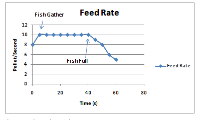

The ability to perform demand based feeding hinges mainly on the ability to measure the feeding rate of fish. It is critical that we are able to measure the amount of pellets eaten by fish [in pellets/second] to watch for a decreasing rate of consumption. An Idealised representation of this can be seen Below, any food delivered after a fish has a full stomach is wasted food.

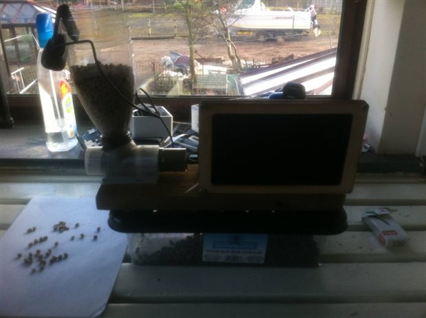

Hardware
Figure 6 Shows the Prototype Hardware, consisting of:
>Camera [Cheap usb webcam]
>computer [Pi +OpenCv] Thanks E14 for the Pi!
>Fish Feeder
>Simulated Pond
>GUI [Touch Screen]  Thanks E14 for the Screen!

The prototype was built to achieve the following:
>Measure number of food pellets in camera view
>Perfom actuation on this information to keep pellet number above a predefined amount

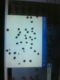

We need to Turn a usb camera image into machine useful information, this is done in stages...
Performance: It works as expected in simulated conditions and a real world experiment with a large fish tank without fish.

Pick highest contrast colour and turn to Gray scale  image
Step 4
Use a Gaussian adaptive threshold technique to turn to a black and white image
Step 5
Now we have black blobs on a white background we can use a common Blob detection algorithm to identify the number of pellets in camera view.
Thats it , now we can measure the amount of food in the tank and teck how much of it a fish is eating in pellets/second...

    DAB over 10 years ago
    Nice update.
    From your graph, I would think that you could use smaller doses of food and then monitor the number of fish still waiting.
    I have very limited experience with fish, but from my fishing days, I know that fish do not gather for food when they are full.
    If this holds true in your setup, then you may be able to use an extended feeding algorithm based upon the number of fish gathered.
    I have seen videos where people have trained their fish to respond to light or sound so that they gather for feeding.  You might be able to do a simple Pavloff study to verify if they could.
