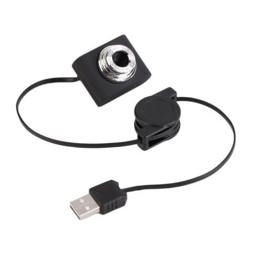

OpenCv can perform all of these functions using a rapsbery pi and one cheap webcam [like the one in the image below].
The camera that works and is cheap:

>Plug in a usb webcam into the pi [the cheap square ones from ebay work well $3]
