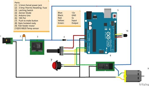

This Update contains the wiring diagram and code for the temperature compensated feeder. This code is enough for you to make a unit to test if it works for you. I am pulling my time of day from another MCU running in the greenhouse, I advice wiring in a gps unit if you are making this a standalone unit.I will be doing a tutorial on this and how we use the time for regulating feeding timings in the near future. This is just a basics of how we compensate for temperature changes.

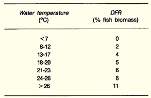

So why Compensate for Temperature
Most Species of Fish are cold blooded animals and as such the water temperature that they live in has a big effect on how they behave. In short cold water makes the fish slow and less hungry. As engineers what does this mean to us, well it means we have an input to a system that needs to vary with temperature if we want to use open-loop control. Luckily almost every aspect of a fish can be represented mathematically or at least  closely approximated.
Below is a table representing the amount to feed fish [Tilapia] as a function of temperature to maximise food productivity[1]:
DFR: Daily Feed Rate, represent as percent of fish mass in the system.
As you can see the Water Temperature has quite a large effect on the amount of food Fish will Eat. I prefer Closed-Loop Feedback Systems, see the previous blog [Blog 5] to see how we can implement this to systems with floating food, but for systems with sinking food I am yet to think of a way to measure the food present in the system [Not to say one of you wont have a solution they feel like sharing?]

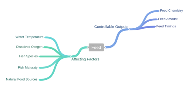

Other things that will effect how much to feed fish:
So far we have only considered the effects of temperature on Feed amount, the coming Blogs will address the other Factors in great detail, but for now here are some outlines:
Feed Spacing/Timings
The optimum time between feeding of fish depends on the size of the stomach of the fish, when they are young they require feeding regularly, decreasing as they grow larger.
Feed Chemistry
The percent of protein you fed fish is related to the age of the fish and the water temperatures.
A Note On DO:
Dissolved Oxygen measurements are expensive, measuring probes need constant calibration and as such we will be assuming the pond has adequate oxygenation for growing fish. Spreading the feed serving over the day will spread the demand for DO over the day also. So in short, feeding multiple times a day decrease the peak demands for dissolved oxygen of the system. [this is a good thing]
The Wiring diagram:
You might notice that there are no external pull up/down resistors in this circuit, I dislike soldering resistors so every thing is implemented not to need them.
The button is connected to Pin A4, that is set up as an input with the internal pull up set to on, when the button is pressed it will pull A4 to LOW.
The Temperature sensor usually has an external pull up, but we are using a modified one-wire library that does this using the internal pull ups for the data pin.
