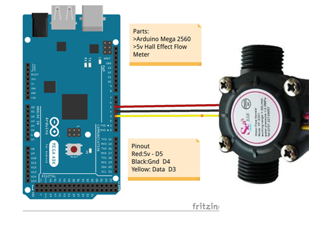

I am sure a lot of you are also working on ways to keep an eye on water flow, So I thought I would make a blog covering my implementation.
I opted for a hall effect flow meter because I salvaged it a while ago and had it handy. It has been up and running in the greenhouse for a while now as part of a larger code, Ive pulled the meter portion out and it is below, I've got no spare arduino to test it works but it is pretty simple [Point out any problems you see].
How It works:
I dont like the approach of measuring the frequency to calculate flow rate and then integrating to get water flow, So It works the opposite way.
>ISR to log number of pulses
>Convert the Pulses/second for a flow rate
>Logs Total Pulses for total water usage
>Checks there isnt a major leak [flow rate is reduced because I use drip irrigation]
Things to keep in mind, the serial will reset every time you reconnect so it isnt goof for final implementation, the clock will roll-over every 50 days and could output one bad reading every 50 days. This code is commented to allow anyone to implement it and you guys at Element14 will find them a little obvious,sorry.
Code - ISR Based FLow Meter

Recommendations: Add a LCD/ IOT solution to remove the serial resetting problem, add a uptime counter.

    Hi Michael Very interesting post. Could you provide some details about the flow meter? Seems to be a nice product, since it can be powered using an Arduino pin
  • m.ratcliffe
    m.ratcliffe over 11 years ago in reply to amgalbu +1
    The one I am using is old [Farnell had to look in their archives for the spec sheet, old]. This is the modern equivalent But any hall effect based flow meter should be ok for powering by any arduino pin…
