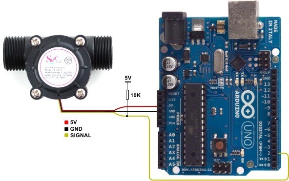

In the previous water meter Blogs we used a cheap flow meter to give us a measure of water flowrate and total water used. The flow meters are cheap and the spec sheet can be misleading, this code is used to get a real world value of number of pulses per L of water delivered.
>Connect the water meter in-line, and prime system
>Turn tap off
>Start Arduino
>Turn tap on to fill up a known volume
Clicks per L= Volume/Pulse Count   [Volume must be in L]
We can use this value in our previous code to get really accurate readings

    Components:
    See main folder for sensor data sheets, required liabaries and extra information: [can be downloaded via www.michaelratcliffe.com]
    All power systems should be powerd of DC voltage of below 48v for safter [water is around] 12v is prefferable and cheapest. As always this is a DIY project and done at your own risk.
    >Arduino Uno
    >Hall Effect Water Flow Meter 5v
    >LCD button Shield [Hobby tronix]

//Stoping noise from being a problem, pin is high untill hall sensor pulls it low
pinMode(Water_pin, INPUT);
digitalWrite(Water_pin, HIGH);// saves having an external pullup
//External Interrupts: This is what the watr meter pulse count is collected from
attachInterrupt(0, WaterCounter, FALLING);  //watermeter pulse output connected to pin2

    They are great products, the spec sheets arnt that accurate but for a few dollars they are great.
    Its a inline turbine with magnets mounted and a hall sensor to pick the turning motion up, so not much to go wrong.
