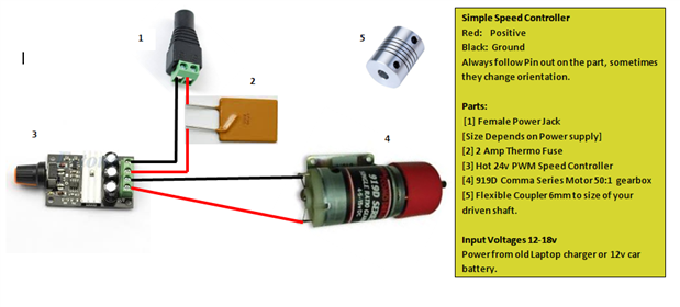

The Pinout:
The Parts:
[1] Female Power Jack             [Size Depends on Power supply]                             $1
[2] 2 Amp Thermo Fuse           [dont try to skimp and do it without a fuse]               $1
[3] Hot 24v PWM Speed Controller                                                                           $2
[4] 919D Comma Series Motor 50:1 gearbox                                                            £33
[5] Flexible Coupler 6mm to size of your driven shaft.                                               $4
[6]L-Bracket to mount the motor Make this to fit your extractor
You might not find the correct coupler for your extractor shaft size, buy one a little smaller and drill/hone it to the size you require.
And a power supply of your choice, I use an old 18v laptop charger or a car battery and terminal clamps depending if the location has mains power or not. I enclosed my controller in a PVC case with a on/off switch to stop honey getting on the electronics, I advice you do something similar.
