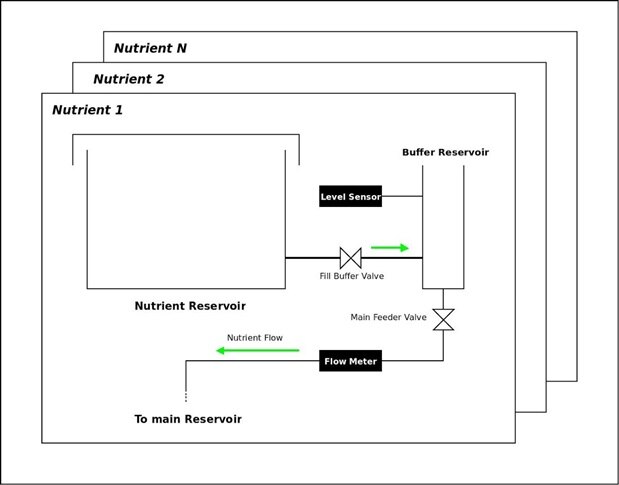

The system will feature as well an automatic dispenser for 2 different nutrient concentrated solutions, water, and a pH regulator (mainly an acid to lower the pH) according to the following diagram:
The dispensers use the same working principle. A Main reservoir holds the liquid and controlled electrovalves are used to transfer a certain amount of this liquid to a buffer reservoir. A level sensor is used to determine the volume of liquid that will be poured on the Nutritive solution reservoir. When the correct level is detected the fill buffer valve closes and the liquid is released passing through a flow meter that double checks it as a safeguard.
Once on the nutritive solution reservoir, the different components are mixed and oxygenated by an air pump to achieve an homogeneous solution. The reservoir is constantly monitored by an array of sensors ( pH, EC, temperature) in order to keep an optimum balance on the solution parameters.
