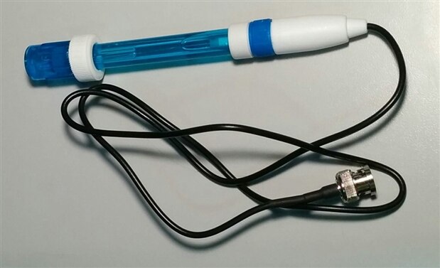

We will be using the portable meter HI9813-5 and combined measurement probe (HI1285-5) from Hanna Instruments for precise  temperature, pH and EC measurements as a reference ground through. This will require  periodic probe calibrations with reference solutions.
We will integrate and calibrate a cheaper pH sensor probe (see picture bellow) and a NTC resistor to monitor the pH of the nutritive solution and check its performance as an alternative affordable solution.

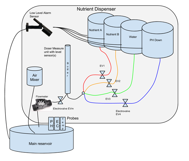

An overall schema of the automatic nutrient dispenser implementation can be found on the next figure.
Our automatic nutrient dispenser will use the two nutrient solutions(A+B), the water and a pH down(acid) solution to keep the solution on the main reservoir on reference levels of pH and EC.
The nutritive solution and oxygenation will be achieved via air pump and porous stone that will generate the turbulence required.
Level sensors on each reservoir will trigger alarms when critical low levels are reached and a refill is required.

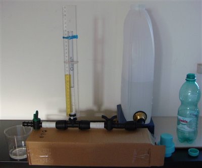

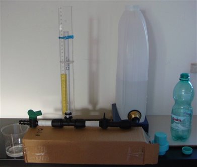

One nutrient doser prototype was assembled to test the behavior and implementation feasibility of the proposed system as shown on the next pictures.
As the electrovalves are on the way we simulated its behavior with manual valves. The buffer recipient is a transparent tube of 10 mm inner diameter that allows a rather decent resolution of about one milliliter per linear centimeter.

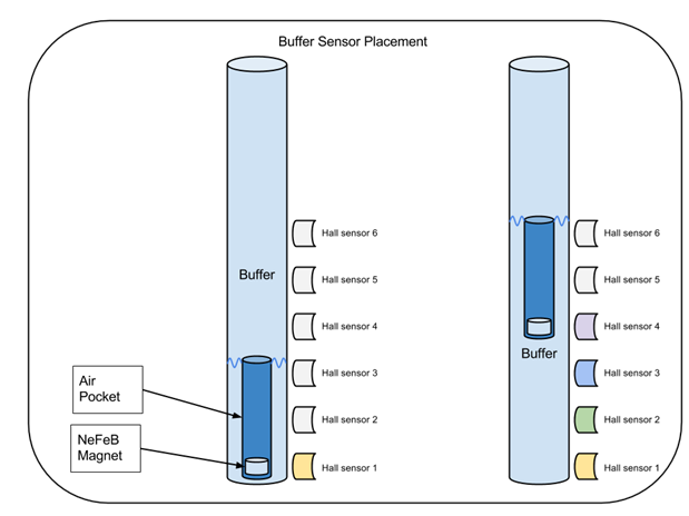

We will implement a level sensor with five different elements spaced about one centimeter each to be able to sense and fill different volumes of liquids in the tube. We are still struggling with its implementation as either magnetic or optic sensor options will have their advantages and disadvantages. For instance on our first trial with a magnetic sensor the float element could not sustain the weight of the magnet. Also our attempt with optical sensor (IR Led + photo-diode) revealed some susceptibility to the ambient light.
As an example, the planned implementation for a magnetic level sensor is presented on the next image.
