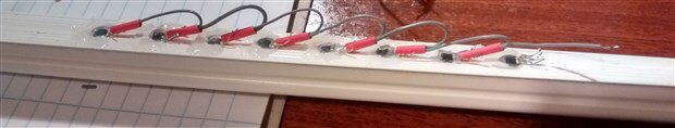

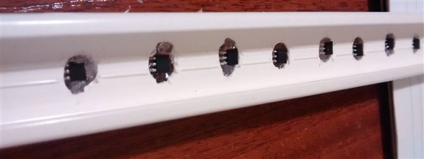

So we attached eight hall sensors (AH3503 from Nanjing AH Electronic Science & Technology Co.,Ltd.) to a cable-trunking and we fit on it the buffer tube of our doser as can be seen in the following pictures.
Figure 1. Front view of the sensor showing hall sensors. The tube fits above.
Figure 2. Rear view of the sensor during soldering process showing power and signal cables.

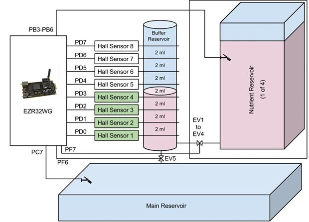

As you may remember we are using 4 reservoirs containing 2 concentrated nutrient components, water and a pH corrector (typically an acid). Sequentially the buffer reservoir is filled with each of the 4 liquids while its volume is controlled via the magnetic sensors. The sensors were placed linearly to have a resolution of 2 milliliters of liquid in the tube. Once the required liquid volume is reached the respective electrovalve stops filling the buffer reservoir and the discharge electrovalve discharges the liquid directly into the main reservoir.
Inside the tube there is a floating container filled with air and a neodymium magnet.
Hall sensors are connected to the eight channels of EZR32WG ADC. The following diagram illustrates the connections of the sensors to the board.
Figure 3. Connections to EZR32WG.

As the magnetic field decreases strongly with the distance we had weak initial measurements. So we needed to file the tube in order to decrease the distance between hall sensors and the magnet.

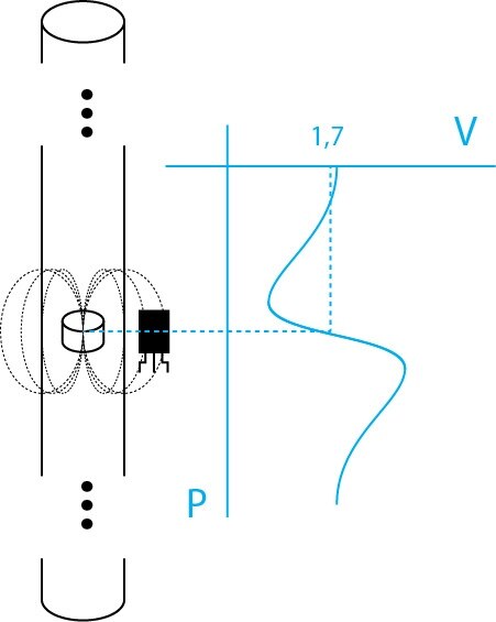

Another challenge arises from signal processing. As the fluid rises into the tube and the magnet passes by the sensor we get a signal of magnetic field measurements similar to a sinusoid (see figure below). This signal needs processing to result in useful level information.
Figure 4. Doser diagram illustrating the signal, where V is voltage and P is magnet position.
The weight and shape of the magnet are also cause for concern due to signal strength and the need to float on the fluid.
