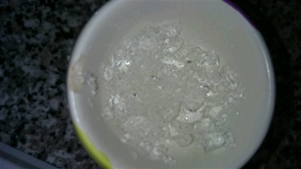

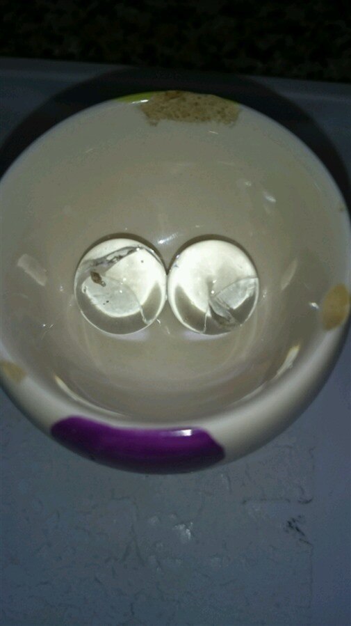

Seeds have arrived and I have started testing 2 different germination methods
I wont be using these plants in the official tests these are just for abit of learning on the side as we do have thousands of seeds
Maybe I could make a lettuce roof on my house
One set is placed inside polymer balls the other mixed in with crushed up polymer balls not very easy to see but there is one seed inside each ball and 3 in the mush
I will take multiple images of these as they progress or if they progress
