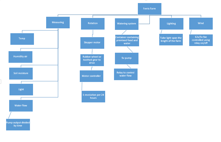

I am going to go through my initial design idea in this post and where I am currently at on the design stage
Firstly I made a quick flowchart with the basics of everything i will be adding into the farm and some notes on how it will be used
i like to work from charts or tick lists so that when I start getting parts finished I can mark them off and I can see where I am and what to do next

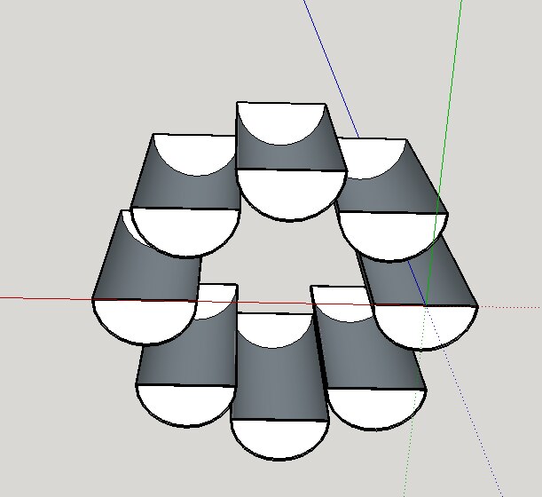

The planters will be made using 112mm diameter pvc pipe (drainpipe)
I decided to go with this because it is designed for outdoor wet use meaning i have not got to worry about light making it brittle as fast as it would some other materials
i have 2 options for closing the ends i can purchase the end caps but this will add more length to the diameter
or i can cut half circle pieces of plastic and attach them into place
these will connect to the frame using plastic or wooden dowels that run the length of the farm
brackets will hold the planters in place while still letting them swing round keeping them horizontal

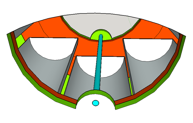

the picture to the left shows how the tubing would sit inside the farm the current layout would be closed at one side and water fed through the other i am thinking about feeding the water in through both sides to eliminate one side getting the water and the other not

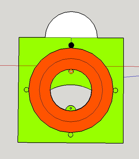

Here is the rotation mechanism and the outside frameimage
the idea is to use a disk to rotate the planters instead of a solid circle this would use bearings on each side and a stepper motor with a rubber or toothed gear at the top
both sides will have a motor and will turn in sync with each other (i hope other wise i will have alot of soil to clean up )
this way i can use the space in the centre to access the planters for watering and sensor testing
the white area at the top will be for mounting the lighting

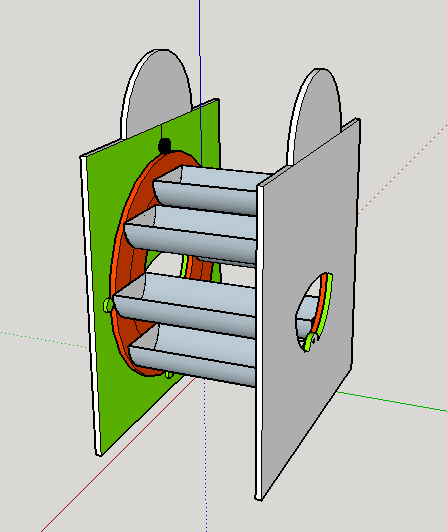

Here is a view of the model with all of the parts (it looks narrower than it actually will be)
the electronics will be attached on the outside above the water system and also on the opposite side to the water system the frame will be held together from the top back and bottom with the front and half of the top open to view
this could then have a hinged lid to completely seal the unit from outside light if this was needed
the wiring will run across the bottom to connect the watering system to the the electronics
i feel that it is best to keep electronics and water as far apart as possible just in case spills happen

    I like this concept, I have seen it done with a single cooltube light running through the center. Inverted planters so the plants point towards the center of the circle vs outside, means 360* light. Maybe…
    I like this concept, I have seen it done with a single cooltube light running through the center. Inverted planters so the plants point towards the center of the circle vs outside, means 360* light. Maybe inside/outside grow, with young plants growing inside 18h light, plants on the outside facing out can be light isolated from the interior. By having two 'zones' you can cycle crops throughout lifespan/light phase & change environmentals independent, increasing planting diversity
    keep in mind that thing will need a high torq motor or gear/chain reduction. You can buy a stepper or servo or use a motor with gear reduction case built in. Alternative, you can build a gearbox with sprockets and chain/belts/pulley. Also, 12v wench motor might be a great solution. Cheap enough @ Harbor Freight, and should have enough torq to spin the wheel. The winch should also have a built-in method for preventing back-drive from the load (mechanical holding). You can power the system with a standard car battery or smaller, and you can charge the batter via solar or hydro/wind. (diy hydro example: https://www.engineeringforchange.org/static/content/Energy/S00070/5%20Gallon%20Bucket%20Build%20Manual.pdf ) Powering from the battery is smart because any motor you choose is going to have to have have good torq, and any motor with good torq draws lots of current. The car battery (12v@50Ah) can handle the current demands and you can scale up the system by connecting more batteries in parallel (12v@100Ah) to power pump's or T5 grow lights. You can also scale the system/sensor voltage by connecting batteries in series (24v@50Ah). Increasing voltage has the positive effect of reducing current draws. Sourcing high current is usually wasteful so reducing system wide current demands is worth considering.
    Thinking about it for a sec. Buy an electric bike motor kit and you will have everything you need. http://electricbikereport.com/electric-bike-direct-drive-geared-hub-motors/
    easy to adapt to your design via the wheel or shaft. Arduino speed control examples available online.
    be sure to have a method for the water to drain from the planters, standing water is not a good thing.

    In my next post i will cover the electronic components i am going to source with 2 or 3 options for each part.

    jw0752 over 11 years ago
    Hi Shane,
    You are off to a great start. You could have moisture sensors in each planter and then have wiper brushes make connection to the contact points on the outside of the planter as it rotates into watering position. This would simplify from the mechanism needed to insert a single moisture sensor.
