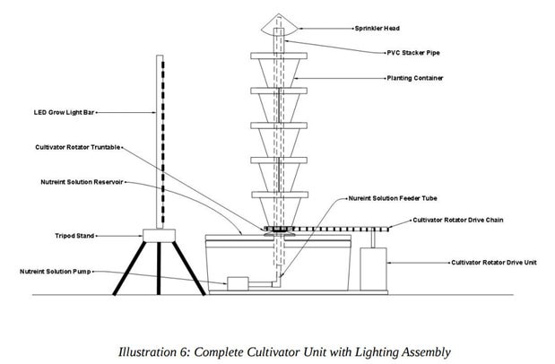

As for new business, I decided to delve into the world of graphic arts and documentation, neither of which am I in any way shape or form proficient. So BE NICE! image I have started a detailed design document. In which, I am attempting to create something anyone could use to implement my design. That said...
On the cultivation side of things
Drawings are not to scale and include no dimensions. The basic dimensions should be somewhat obvious as they relate to the chosen planting containers.And the documentation is my best try at describing the various pieces and assemblies required to build what I call a Complete Cultivator Unit. I am considering this piece of the document completed as of now and will begin on the automation detailed design section next. Hopefully, that will be completed enough to include in my next blog. A .pdf file containing the work to date is attached to this blog post. Please feel free to peruse and make any suggestions you deem pertinent.

    shabaz over 11 years ago +1
    Hi Rick, The format looks really good, I look forward to reading those 4 sections in your ongoing posts. And the Detailed Design Document is incredible - lots of useful information and high quality diagrams…

    shabaz over 11 years ago in reply to RWReynolds
    I've briefly used SketchUp in the past, but so little that I still need to re-learn it each time I use it : (
    Anyway, your results are impressive, I had assumed you had a technical drawing background/experience when I saw the diagrams
    and detailed annotations!

    RWReynolds over 11 years ago in reply to shabaz
    Thanks Shabaz! If I know at least one person appreciates it I will continue that format. image
    I'm glad you enjoyed the detailed design document. I spent a good 10 hours creating the content. The illustrations were all done in SketchUp's Layout application. Google SkethUp and download the free or demo versions. I started using it two days ago, have no formal diagramming education and really very little experience with this type of application. It is incredibly easy to learn and use.
    Yeah, the trick now is to acquire all of the required materials and actually implement my design.
    Hi Rick,
    And the Detailed Design Document is incredible - lots of useful information and high quality diagrams. The cluster/pod method is very cool I thought.
    I hope you don't mind, I thought I'd paste a snippet here of the single unit to encourage people to download your PDF.
