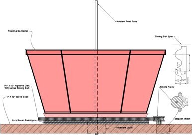

  • A 9" diameter Lazy Susan style bearing, a 10" diameter Masonite disk, a 36 tooth GT2 2mm pitch timing pulley, a 45" length of GT2 2mm pitch timing belt and a stepper motor and control board. The Masonite disk and base will have a hole cut in them o allow nutrient drainage back into the reservoir. These parts will be assembled to form the cultivator rotator unit. See image below.
Here's a small image gallery of the parts I'll be using for this assembly.
{gallery} Cultivator Rotator Parts
I believe I have this system worked out quite well. It works as follows:
The timing motor, USPRO model 28byj-48-5V, I'm using is geared and requires 4096 pulses per revolution. The gearing provides greater control and assures that when power is removed the motor will remain stationary. The timing belt will be inverted and attached to the edge of the Masonite disk. This will form a turntable/timing gear assembly. The stepper motor will be mounted so as to place the timing pulley in direct contact with the timing gear. This forms a push drive for the turntable. I am looking at rotating the cultivator unit 4 complete revolutions per day, this might change. This requires aprox. 160,000 pulses per day or two pulses per second. I intend to operate the EZR32 MCU in low power mode most of the time. It will be programmed to wake up periodically, every 1 to several seconds. The MCU will perform any required control functions including pulsing the stepper motor, read all sensors and log this data back to the central control/monitoring system.

    Nice post. I worry about your stacking approach. You need to make sure that the upper plants do not deprive the lower ones of nutrients. I would also worry about salt accumulation in the lower container…

    Yes, I have concerns as well over the effects of trickle down feeding on the lower plants. My plan is to feed/water periodically, maybe two or three times per day. I am going to implement a sensor at the bottom of the stack that will give positive feedback when the nutrient solution has reached the drain back into the reservoir. I'm thinking, overthinking probably, that if I run the pump for a long enough period after the feedback sensor activates that all plants will receive a good soaking. The containers are built in such a manner that each does a pretty good job of quickly feeding the lower container while retaining solution of its own in a small reservoir.
    I guess I should consider testing the solution in at least the top and bottom containers to determine if the bottom plants are being starved. I have to research what sorts of sensors, other than pH, I might use for this.
