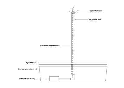

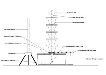

The nutrient feed system:
In this post, I will cover the nutrient feed system for my vertical farming design. Just for clarity I have included drawings of the entire system and the proposed nutrient feed system. These are drawings of the original design, which has been modified to some degree as development has progressed.
Here's an overview of the nutrient feed system modifications that have been implemented to date. Details and pictures of these mods are presented below.
  1. The pump has been replaced with a larger unit.
  2. There is no longer a separate PVC stacking pipe and nutrient feed tube. This now consists of a single PVC feeder pipe connected to the pump and nutrient dispersal halo via rubber tubing. However, the PVC stacking pipe may be reintroduced before completing the project if any stability issues arise.
  3. The sprinkler head has been replaced with what I am calling the nutrient dispersal halo, which was built from perforated rubber tubing and scrap PVC.

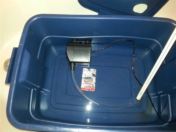

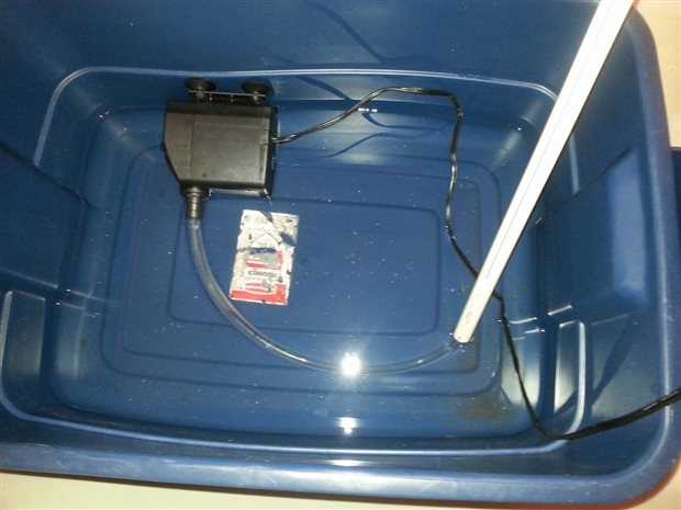

The Reservoir:
The nutrient reservoir consists simply of a re-purposed 14 gallon plastic storage tub. The lid has been modified to accommodate the nutrient feed pipe. It will be further modified, to allow easy access to the nutrient solution and pump,p once the entire system is assembled. My plan is to cut the lid in half and create a hinge by gluing a single length of bicycle tire inner-tube along the length of each half each half.

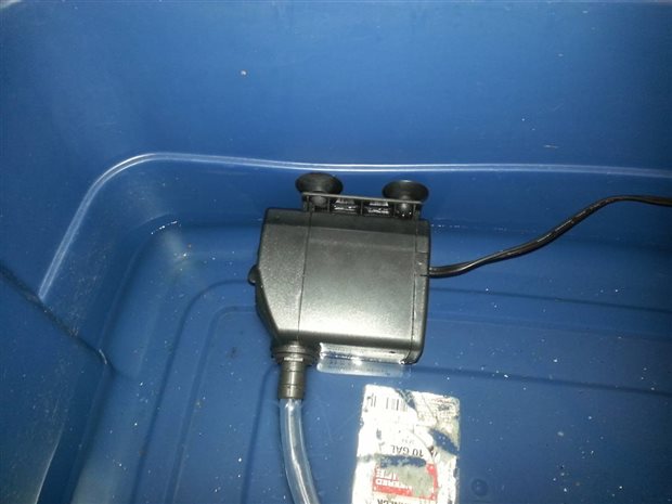

The pump:
My original pump was a 70GPH model with a head lift of only 30". This was obviously not going to do the job as the required head lift is a minimum of  around 60". I now have a 740GPH pump. I purchased this pump online for the same price paid for the 70GPH pump at a local home improvement store. Around $18... The new pump has a head lift of around 102". This may be a bit of overkill, but I believe I have a method for controlling this and making it work very well for the system. These are landscaping fountain water feature style pump. They are relatively inexpensive, very available, come in many sizes and are well suited for the task at hand. In my application head lift is the most important specification as I need to pump nutrient solution vertically and to a specific height. See Table 1 below for specs on some of theses pumps.

This is the 740GPH pump I'm currently using. But it may have to be reduced to lower the water pressure at the dispersal halo. I'm getting a lot of splatter right now. And I'm also concerned about the effect on the growing medium in the top container.
PVC feeder pipe:
Not much to say here. I simply did away with the outer, stacking, pipe and now have a single, approx. 40" x 3/8", length of PVC pipe that feeds up through reservoir lid, the rotator unit and the middle of the stacked containers. The container stack simply rotates around the feeder pipe, which remains stationary. The feeder pipe will be connected to the pump via a 90-degree elbow, for stability, and small length of rubber tubing. Currently the rubber tubing is connected directly to the feeder pipe. The dispersal halo is also connected via a 90-degree elbow and rubber tubing. The picture below shows the lower portion of the feeder pipe in the reservoir. There is a video log at the end of this blog post that shows the pipe in place with the growing containers stacked over it.

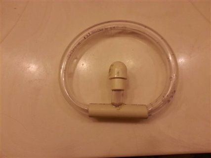

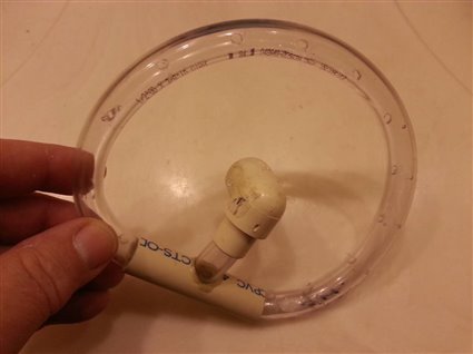

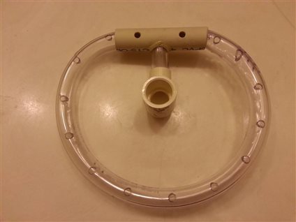

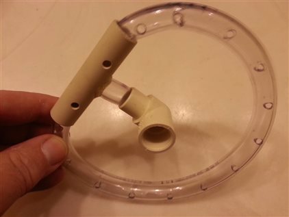

Nutrient dispersal halo:
In the original design, my intent was to design, and have 3D printed, a custom sprinkler head for nutrient dispersal. But after seeing one of the other challenger's, shanesissons, solution for nutrient dispersal I borrowed from him to create a new and much simpler design. Shane created a simple perforated tubing solution for his Ferris Farm design. I have adopted that idea but formed the single length of tubing into a halo shape as it is more suited to my application.

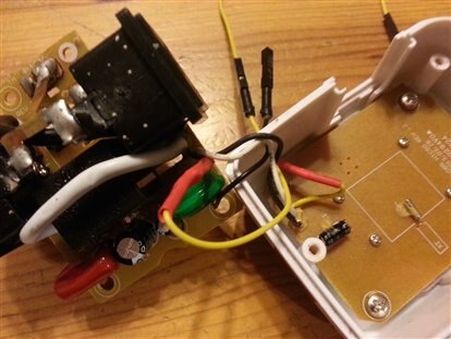

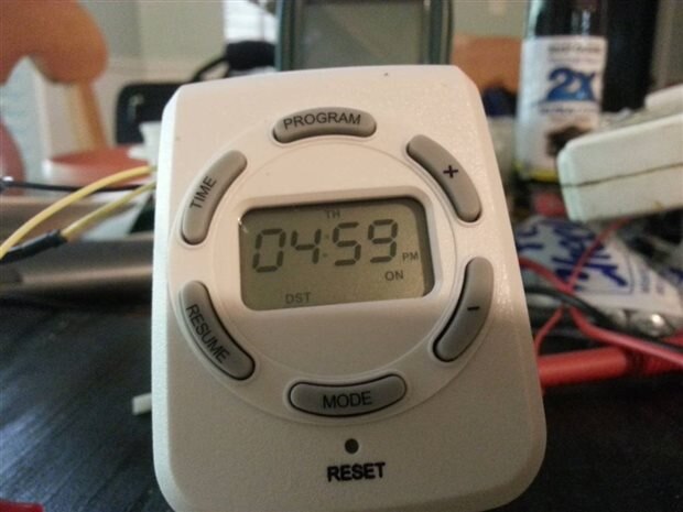

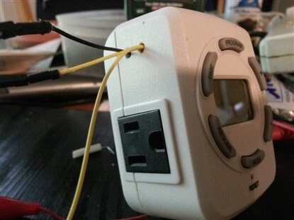

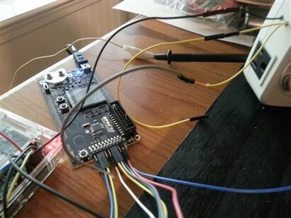

Nutrient feed pump timer/controller:
I wasn't sure what to use in order to control the nutrient feed pump. The intention is to have the pump activate automatically several times to day to flood the plants containers. So. I knew it had to consist of a relay and timer circuit of some sort. And as I've reached my budget for this project it was time to get creative and find something to re-purpose. So, luckily, I found an old hot water heater timer in my shed and realized it had everything I needed and then some.
I believe I paid about $10 for this unit when I first purchased it. It's really quite nice actually. It provides 8 programmable on off cycle times. But I wanted the ability to log the on/off times of the unit and the ability to control the relay directly from the MCU. So, I hacked the device and was able to bring its relay control line into the EFM32ZG via one of the analog comparator pins on that are broken out on expansion header. I used a comparator pin because the output voltage of the timer's control line is only 1.3V. I believe this was not enough to drive a standard 3.3V GPIO input pin on the MCU. I also connected the other, input, side of the control line to a GPIO pin on the EFM32ZG expansion header. Again, the output pin from the MCU is 3.3V so I will use a small 1K x 1K resistive voltage divider to bring that down to 1.65V, which should be safe for controlling the timer device relay. NOTE: You will notice that the common of the timer device, black wire, is connected to the Raspberry Pi expansion header. This is simply for convenience as the RPi common is connected to the EFM32ZG common and this device provides only one common connection on the expansion header.
Now I can set the timer via it's provided front panel programming capability and also acquire, via the analog comparator connection, the timer relays on or off cycles. Or, I can control the the internal relay directly from the EFM32ZG via the direct connection between the MCU and the relay control line. The analog comparator alternate function of the MCU is quite handy. The comparator is configured to provide two separate functions when it is triggered by the timer device's control line. One, it will basically echo the level transitions of the comparator inputs to an output pin on the MCU. Two, it will generate an interrupt so that the software can respond to the transition. This allows me to both easily echo the transition back to the timer to activate the relay, and to send the transition event to my cloud based IoT logging service. Here's some pictures of the hack. And again, this is covered in the video log at the end of the post.

    Enrico, I think you are correct. Cutting the reservoir lid in half could potentially weaken the structure and cause problems with supporting the based and container stack. Again, it should be simple enough to build a small surrounding structure to support it if this becomes an issue.

    balearicdynamics over 11 years ago in reply to RWReynolds
    Hi Rick, thank you for the answer.
    Good idea for gluing the pump. The issue is not visible in short term but also with apparently clean water after one month of continuous usage (immersion) the problems start arising.
    What I was worried was the method you told about cutting to the half the reservoir etc. But maybe I have not understood very clear what do you mean.
    Happy if my "warnings" are useful, happier if are already considered in the project.
    About the motor power I think that this is sufficient up to at least 50 Kgs, especially with the very slow speeds you should work.
    Enrico

    Hi Enrico,
    Thanks. It is nice to see it progressing. I think I have the individual subsystems worked out well enough to start putting every thing together over the next couple of weeks.
    I have tested the rotator system under load, I think I got it to around 15 - 20 kilos. I didn't record the testing I was doing, I need to start doing a better job of that. I don't know what the final max load will be. My estimation at this point is around 20 - 25 kilos. If it does become an issue my first backup plan would be to go to a belt driven system. If it turns out that the motor is just not powerful enough I'll replace it with something with a little more torque. The retrofit shouldn't be too difficult.
    The current plan is to place the plywood base directly on the reservoir tub. But again, if i see issues once it's setup and under full load then I can easily build a small platform over the reservoir for the base to sit on. I may do that anyway as it would make access to the tub easier. Please do post photos of anything you think might be helpful. I appreciate all input. image
    Thanks for the warning concerning the pump. I have not tested enough to have discovered the problem. I think what I could do to alleviate any movement is to use Gorilla Glue to permanently fasten the suction cups to the reservoir. There's quite a bit of Gorilla Glue in the system already. The stuff is amazingly strong and waterproof. And relatively easy to work with.

    Hi Rick,
    simply great! It's a pleasure to see the project growing day by day.
    As usual (hope not boring you) I have a couple of questions / suggestions, if you have not yet though. I continue my worry-line about the stacked weight and mechanism. I see that you plan to put all on the base of the solutions. Is this the final choice or not? I suppose not, but if it is so, I see two problems. The first is the plastic cover, that seems too thin and flexible to support the stacked parts, motor and terrain etc.
    The second is about this idea. I had had to solve a similar problem and this methods revealed not affordable. If you can reach a marine tools supplier somewhere around there is a specific solution that I am using and is working stable by about two years with an expense between 5$ and 10$ Let me know if it sounds interesting method and I will post some photos of how I have solved here.
    A last detail is a warning: I see that - as in my case - the pump is just posed on the water with the four suction caps. I have done the same with a pump of almost the same size and after a week I started discovering the engine "navigating" on the bottom of the canister. The problem is that the low frequency vibrations of the pump motor and the micro components in the waters tend to free the suction cups. The only reliable solution I have found was to lock the pump with four screws then waterproofed with simple bath silicon rubber, specific for water.
