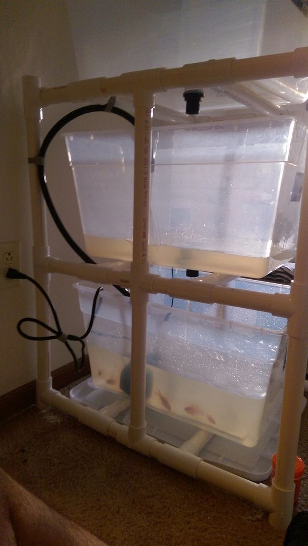

Base Frame Structure Complete
The base frame of the structure, including the fish and sump tanks, is complete. I definitely underestimated the weight of the tanks; therefore, the structure itself had to be redesigned. I strengthened the frame by adding one more column in between the corner columns to even out the weight distribution. The structure is now sturdy enough to support (170 lbs) or about 77 kg.
The frames is made of 1" PVC pipes. The joints themselves are not yet cemented as I am still seeing if I like this design of the structure. Despite changes to the structure to accommodate more weight, the function of the structure remains the same: ease of adaptability when an inevitable problem to arise.
The area for each tank/container is enough for us to remove if a problem should ever arise. With this set up, each section can
be temporarily replaced if a problem should arise. This gives us flexibility to also hone in on a issue with the system by
allowing us to focus on one section at a time. This design also allows us to change the shape of the whole structure itself.
If I wanted to shorten the structure, I can decrease the height of the fish tank area, and place a shorter tank (I would not
want to reduce the size of the sump, since I always want to make sure there is enough water for the system).
This is what the structure looks like now:
The Mini Plant 2 Base Structure
While I was working on the system, my friend came for a visit. She saw the structure and asked me why I had not just bought a shelf, or made the shelf out of wood? This is completely justified question, so I wanted to answer it here as well,
in case anyone was wondering the same.
We chose PVC, instead of buying shelves, for various reasons, but specifically we were going for a clean look. PVC pipes are meant to be in contact with water, so if any water reaches the structure, we have no worry of the wood rotting. But one of the main reasons we chose PVC is so that we can wire the system through the pipes. Wiring the system through the inside gives the frame the extra duty of protecting the wiring. The version of our Mini Plant had the wires of the lights hanging throughout the
system. The hanging wires made the system look incomplete and could definitely be dangerous if problems would have risen
(A.K.A. water would have spilled from the tanks). Wiring inside the frame of the structure protects the wiring, and gives the
system a cleaner look. Eventually, we want to be able to connect the sections of the structure frame magnetically to administer
a clean connection, while completing the system's circuitry.

    DAB over 11 years ago +1
    Quick answer would be the advantage of the PVC pipes for running wire and fluid conduits so that they were not visible. Also I think the pipes probably have better structural integrity than most book or…
    DAB over 11 years ago in reply to e14 Contributor +1
    For structures, you really cannot beat PVC pipes. I would recommend vinyl gutter material for the planting surface. They are quick to fashion and allow the free flow of fluids around the root system. Luckily…
    Luckily, there are no lack of potential material that you can reuse.  Boards, bricks, pebbles, plastic bottles, cement, play doo, just about anything you can manipulate.
    All it takes is a creative mind and some perseverance.
