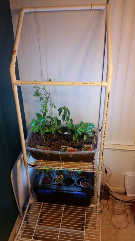

The Plant is a project I began earlier this year to try out aquaponics. I've read about aquaponics dozens of times on the internet, and how amazing it is. But, the whole time I was reading these articles, I was wondering: why has aquaponics not picked up as a major method of food production? I did research, built a system, grew a few plants, and maintained a group of thirteen goldfish, and this is what my system turned out to look like:
The Mini Plant

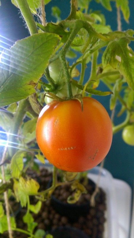

The system worked. The plumbing worked perfectly at an estimated cycle rate of 6 gallons every minute for a 32 gallon system. A system that only cost me about $150. Provided us with a few tomatoes,
First Tomatoes

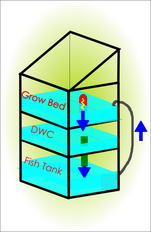

and enough basil for us to make our own pesto sauce. We felt so good that aquaponics was going to work just based off of this system, we named our project "The Plant" and dubbed my small aquaponics system "The Mini Plant". This is how the whole system's water cycle worked:
The Mini Plant Water Cycle
But after a few weeks, there were problems. Fish were dying, plants were dying, pumps were breaking. I found my answer as to why aquaponics has not been picked up by the agriculture business. This is why we are competing. We are developing a less risky maintenance method, in hopes that a commercial can be spring out of these projects.

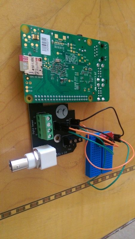

The second version of the aquaponics system will need a pH regulating system. If the pH of the water begins to rise, I need the system to warn me. Let me know if I am feeding the fish too much or if there is a dead fish floating around. We decided to include a pH sensor from Atlas Scientific along with the Raspberry Pi to let us know the system's pH condition. Working with the Raspberry Pi was, of course, a decision we made before knowing we were going to work with the EZR32. We plan on designing an embedded system that will keep an eye on the pH. Once we set the range at satisfactory pH levels, we leave the pH sensor in the system. While the sensor is sitting in the system, we want it to collect data, and send it over to a database all through the internet. This way we can further study how the PH affects the system. But if the sensor package starts picking up undesirable levels, the system warns us. We are looking into receiving a text message or message on our main computer, but the manner of warning has not been officially decided.
Current Sensor Package Work:
We began work on our system before the start of the competition, because we wanted to complete this project with or without being allowed to compete. We ordered our Raspberry Pi and Atlas Scientific pH sensor kit. While we waited for kits to arrive, we started work on a database collecting system through the internet. I will mention how the server works more in depth in a later blog. Also, Something to note is that my team is located in California, while I am at my new job in Illinois, so having the system work online is a requirement. Once I received the kits, I plugged everything in (there were a few pieces missing so I jimmied it as best as I could, but I got it working =D )
Raspberry Pi Set Up
got a quick Python script to test the kits.
Once we verified that everything worked, we set up the Raspberry Pi with SSH, and had a team member run the code from California. So far everything is working well.
