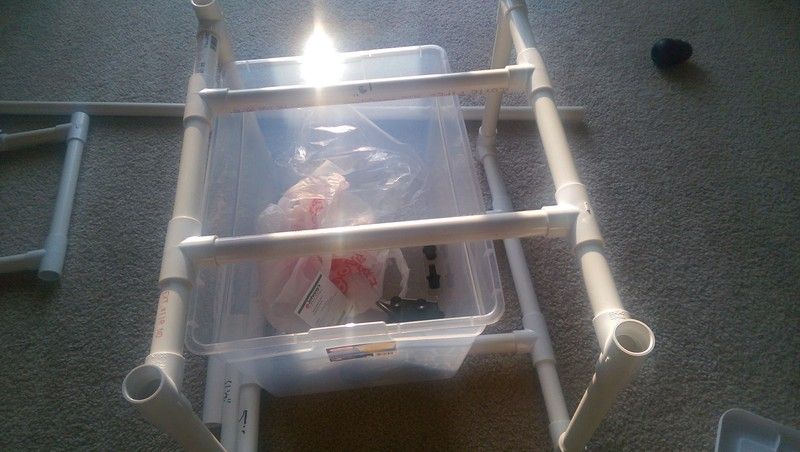

The framework for the whole system is currently under construction. We had decided to make our structure out of PVC pipes because the material is cheap, water proof, and gives us full control of the structure's design. The first module of the system, the module that will hold the sump tank, is complete. The module that will hold the fish tank will be done as soon as the material come in. The construction of the structure is the only part without foreseeable problems so far. Knock on wood.
Sump Tank Structure
