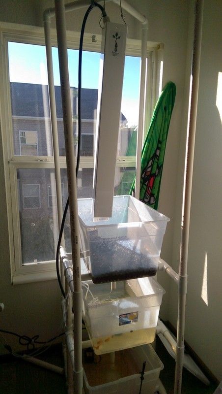

For the sake of keeping everyone updated, this is how the system looks:
The Mini Plant
We are trying out Bright Agrotech Grow tower to add extra growing space. I think it will do well. We added a few practice plants to get started. We plan on adding maybe two more towers, and have the growbed under the towers to allow other plants to grow that are not supported by the tower. Out of 10 fish, 6 are alive. I do want to point out how it is funny that Luke, Leia, and Dave are still alive. Han died. =C Hopefully that is not foreshadowing……

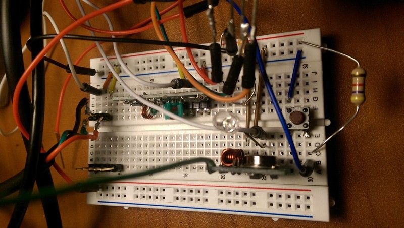

Here is our breadboard during the time we were working on the RF outlet switch. (The button is a foreshadowing of a blog to come). Note that I added an LED to the signal , and the ground of the transmitter to let me know if the RF message is being transmitted. Super useful during troubleshooting.

Like I said before, our main controller is the RPi, so this guide was straightforward, except if you are using the latest version: Jessie. The guides on the links work well until you try to send an RF message. If you followed the link's instructions, you will find that the RF signal is not being transmitted. The problem lies with the Apache2 install.
The only problem with how this (and all other similar tutorials) on installing this RF receiver and transmitter, is the placement of the folder containing the RF transmitter and receiver information. The tutorials tell you to download the folders to:
$ /var/www/
But from my understanding of reading several forums, it seems Apache's new root folder is:
$ /var/www/html/.
After installing the changes, I had to reset the Apache server with:
$ sudo /etc/init.d/apache2 restart
From this point forward, using the sniffer or sending out RF signal comes through this directory.
This change in directory fixes both the problems of sending out the RF signal, and seeing the nice PHP webpage control layout the great tutorials mention. I do also have to note that the antenna you solder onto the transmitter needs to be long to get a strong message. I have my RF outlet switch just under the table, and it wasn't until I attached an 8 inch wire, that there was a 100% successful message transfer.
