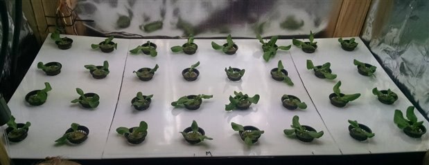

I planted these seeds and put them in the germination section on 10/20. Here they are on 10/28 :
The germination rate was 100%, but the timing was off by severaly days. Ideally all of the seeds should germinate at once and sooner than they did. I determined that this problem was due to uneven heating of the germination section from the heat from the lights on the level below. You can see in the picture that the seedlings on the outside were more developed than those in the middle. The middle was just too warm for lettuce germination. This will have to be corrected for future plantings. For now, the result was not ideal, but acceptable.
