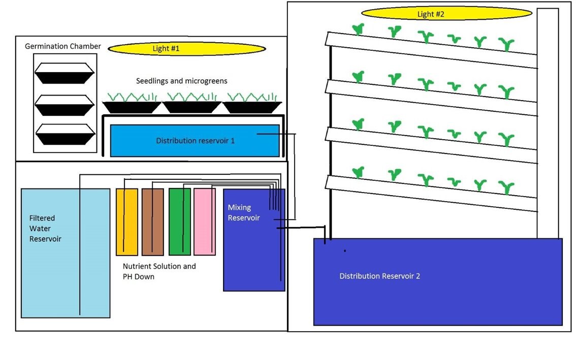

One of the most important parts of a hydroponic growing system is the solution used to feed the plants. Creating and maintaining this solution can also be the most time consuming. The first part of my system will consist of four reservoirs. The first will contain filtered water that is refilled manually (potentially automated if time and cost permits) whenever it gets low.
When a new batch of hydroponic solution must be created, water will be pumped from the first reservoir to the second. An ultrasonic distance sensor will be placed at the top of the second reservoir in order to measure the amount of water added. Four peristalic pumps will be used to add the appropriate amount of PH down and a three part nutrient solution according to a predetermined recipe.
Finally, the solution will be pumped into one of two distribution reservoirs for delivery to the plants. These reservoirs will hold the solution that is recirculated through the two growth areas. They will each contain an ultrasonic distance sensor to measure the water level as well as a submersible pump with tubing that distributes the water to the plants. The pump will be controlled through a relay to ensure that the plants are receiving the correct amount of water.

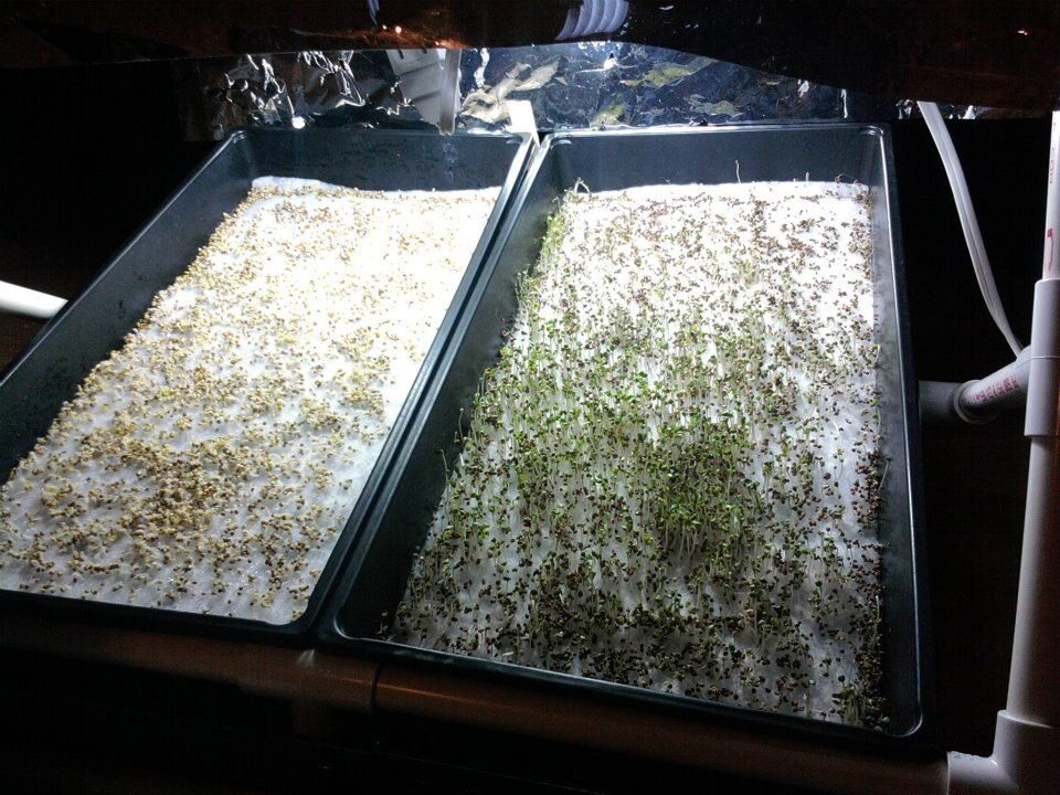

Seeds for green and herbs will be started in rockwool or another suitable growing medium. Microgreen seeds will be broadcast onto a synthetic growing medium. They will spend their first 2-5 days in 10” x 20” nursery trays that are kept between 70F and 80F with no light and  >80% humidity.
Seedling and Microgreen Growing Area
Once the seeds have sprouted, they will be moved to the  There will be three or more trays in this section. Two will be growing microgreens, and the others will contain the seedlings. These trays will be fed a nutrient solution that has a low concentration of nutrients. It will be pumped to the plants 2-4 times per day for 5-15 minutes each time.
This section will be maintained between 65 F and 80 F.

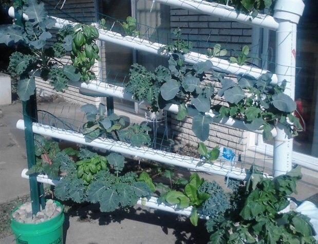

NFT channels will be created from 2” PVC pipe with holes cut in the top. Once seedlings have reached sufficient maturity, they will be moved from the seedling trays to the NFT channels. Here they will receive a much more potent nutrient solution that is constantly flowing around their roots.
Greens like lettuce, kale, swiss chard, and basil will be grown to maturity in the NFT channels. One channel will be populated at a time, and when the plants in the channel have been harvested, it will be cleaned and filled with new plants from the seedling area
This section will be maintained between 60 F and 90 F.  Below is an example of a prototype outdoor hydroponics system I built a few years ago. This section will be similar to the system below.
