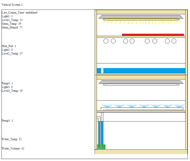

Last week I began work on replacing OpenHAB as the web interface. I still have a lot left to do, but I thought it best to give an update since I have gotten the basic framework working. I am using a BeagleBone Black as the hardware for the webserver. I am using a Debian image for the OS and this is an older version of the BBB so I have to run off of an 8 gb SD card. I am using the standard image found here: http://beagleboard.org/latest-images. Creating a custom image is on the list of to-dos, but it is a low priority at the moment.
I decided to use node.js with express for the webserver. I will be using socket.io for data transmission, and d3.js for client side visualization and interaction. Using these packages means that my package.json file looks like this:

To give a basic idea of what is happening, I have a text file called main_data.txt. This will be used to store the current values of the important variables to display. When a user connects to the webserver, hydro1.js will serve hydro1.html, and open a socket connection with the user's browser to transmit the data. Every second the text file is read and data is sent through the socket. The client side code reads the transmitted data and uses it to create objects suitable for display. The d3.js code then displays different images and text values based on the state of the system.
I created a script called fakedata.js to change the state of a few variables in the text file every five seconds. Doing it this way I can verify that changes to the text file are properly displayed on the webpage. To have this script run automatically in the background, I created a file called fakedata.service:

Finally in the /hydro1 folder I ran:
node hydro1.js
This resulted in the following being displayed on port 8181:
and when the data changes:
I have verified that this works. So I know that as long as I change the data in the text file I can get what I want displayed on the webpage.
I have attached all of the files I am using. Warning: this code is in a barely usable state. I am pretty new to JavaScript and still don't really understand a lot of how it works. I did enough to get the basics working. The code is not commented well, is inefficient, and may be difficult to follow. I've attached it just so that people can see how I am doing this and ask questions or give criticism if they like.
