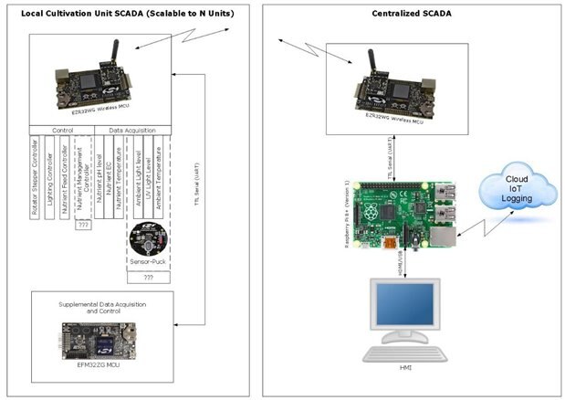

  • RWReynolds
    RWReynolds over 10 years ago in reply to jamesod
    I'm doing the same on a Raspberry Pi James. Could have used a BBB, I have both available, but I've been playing with the RPi lately. lol...
    I actually have an RPi on both ends. On the cultivator end simply because it's the only way I've found to easily read the sensor-puck over BLE. They gave me a sensor-puck and I wanted to use it. lol... The RPi on the central control end will be my gateway to a cloud-based data logger and visualizer. I'm using initialstate.com for logging. So it's EZR32WG to EZR32WG for local control, remote control and data capture/transfer, and an RPi for logging to the cloud, and possibly for additional remote control.
    I've spent my time with the EZR32WG getting the code I wrote for the EFM32ZG ported over and getting everything wired up in an enclosure. I'm using the EZR32WG to control a stepper motor, a pump and read all the cultivation and system sensors. I have the radios talking to each other but no sensor data transfer yet. Seems pretty simple, just bring the radio code from the simple trx example into my code.

  • jamesod
    jamesod over 10 years ago in reply to RWReynolds
    Nice. I am debating between simply using the UART like you have done or trying to use the VCOM port over Ethernet. I'll probably just use UART to get things started.
  • RWReynolds
    My intention at some point is to explore Ethernet on the ZR32WG. But first I just want to create a working system. So, I'm working in some pieces I'm already familiar with to make the development go more quickly.
    I'm curious as to whether I could use the RPi as a sort of TCP/IP hub and gain access to the EZR32WG via WiFi. WiFi to the RPi and Ethernet to the MCU.
