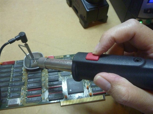

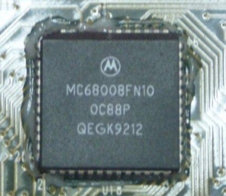

Here a some photos of my Hot Air rework station and I removing a PLCC.
This is just a practice run on a very old board. No ESD protection measures were taken.
Apply flux paste to leads of the component to be removed (this also works for bgas - use specially formulated flux liquid instead)

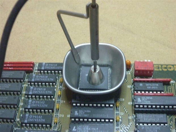

Install heat shield with helping vacuum hand.
The heat shield encapsulates the hot air within its boundaries preventing collateral damage.

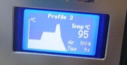

Click on tool button to run a preprogrammed temperature profile
(This particular temperature profile brings the entire component to an even heat at two different temperatures below the solder's melting point and then peaks quickly to raise the temperature to reflow for just a few seconds before cooling and shutting down.)

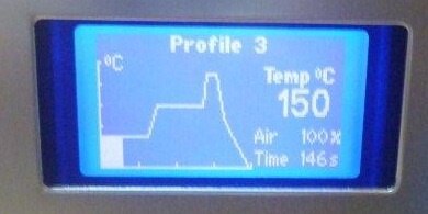

The programmed profile runs through its paces.
I like the way my machine has an animated display to tell me where it is in the process.

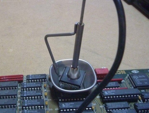

Just at the end of the temperature profile peak the component magically pops off the PCB by itself.

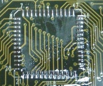

No damage to the PCB or component at all (except some possible ESD damage because I didn't take the appropriate precautions for this practice run).
I just need to clean off the residual flux and remove and unwanted solder.
Just nearing the end of the program and about to shut down.
Just so easy!
