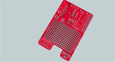

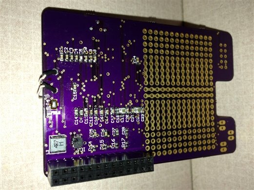

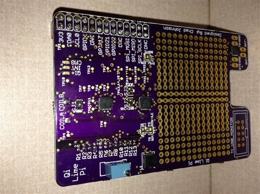

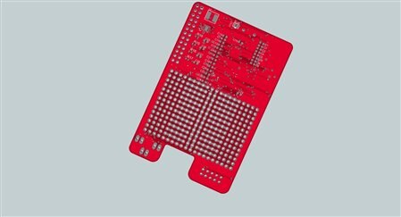

Hello World,
I have completed a sophisticated Highly Efficient Qi Lime Pi ProtoShield. The boards are on their way! The Qi Lime Pi is a Qi/Battery powered and prototyping shield for the Raspberry Pi.
Presenting the Qi Lime Pi..In Red, Green, Black and Moldy Purple!
Front and Back:
My Entry! A Qi Lime Pi - A Qi Powered Raspberry Pi Plate

The battery charging circuit works as well but for my purposes I didn't need the battery charging circuit. I wanted the Raspberry Pi to shut off like a light switch when I pull it off the Qi Transmitter. With the battery the Qi Lime Pi keeps charging the battery until full and then powers the Raspberry Pi until the battery is dead when pulled off the transmitter.
This Qi Lime Pi shield has the following:
Full Evaluation Board Qi Receiver- Has a solder jumper to allow for either a Qi 5V pass through voltage or battery charging functions, comes with lots of test points!
Battery Charger with a GUI Using I2C-A complete charger module for charging compact, flexible, high efficiency, switch-mode charge management for single-cell, Li-ion and Li-polymer batteries.
GUI-Yes this has a GUI. You can download and look at it now right from TI.com! bq2427xEVM_SW_V0001.zip
IC Controlled NexFET Power MOSFET-The NexFET power MOSFET has been designed to minimize losses in power conversion load management applications. The SON 3x3 package offers excellent thermal performance for the size of the package! I had to custom make a SON-8 package for Eagle!
Low Input Voltage Synchronous Boost Converter with 1.3A Switches-More than 90% efficient, Automatic Transition between Boost Mode and Down Conversion Mode, Quiescent Current less than 55 uA. Operating Range from 0.3V to 5.5V, Output short circuit protection under all operating conditions, Power Save Mode, Overtemperature Protection.
I will say it again, It isn't just a battery charger, it is a complete High-Efficiency Switch Mode Charger with Separate Power Path Control!

Best of all I included the connections for a USB kit from Ti so you can program your own battery charger from the default settings and monitor the battery charging process on a computer. So with this Qi Lime Pi shield you are basically getting a BQ24272 Evaluation Module from Ti embedded on a Pi shield.
This Qi Lime Pi Shield isn't for everyone! This is a kit for the people that want to experiment with different battery types, different charging patterns, different voltages, efficiencies, etc. I wanted to make a kit that includes two of the most efficient, best products that TI has on the market right now. I wanted to include functionality to expand to other devices if needed. This board and design will be easy to transfer over to other designs and boards such as the BeagleBone Cape, in which I will show you in my next post! The Hot Qi Dog Cape officially working!
The Qi Lime Pi Slice Shield has arrived and will be put together as soon as I can get my hands on the BQ51050B image that will have just a basic Qi Receiver/battery charger and buck boost for simplicity.
I will post my design files for this Slice version in a later post when I have fully tested this design and have a fully working prototype! Again, The boards have arrived!

    I tried to load your .brd file in Eagle Pro 5.8 and it says invalid data. Downloaded again and still invalid.  .SCH file, too.

    The design files in this post are for Eagle. I would really recommend increasing the traces as much as you can if you are going to order a board. This was the first design and I have already made the rev 2 and shortly soon a rev 3 with the BQ51050B!
