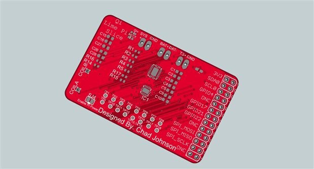

Hello World,
I just wanted to show off a new product of mine called the Qi Lime Pi SLICE. This utilizes the new chip BQ51050B. This new device from TI has a built in battery charger, allowing for over 90% efficiency! The components and PCB space is reduced significantly, ultimately resulting in a SMALLER DESIGN.
Since the new BQ51050B will not be available before Nov 30, I will be showcasing the design and board layout for anyone to use at TI's and My discretion!
Presenting the Qi Lime Pi SLICE..In Red, Green, Black and Moldy Purple!

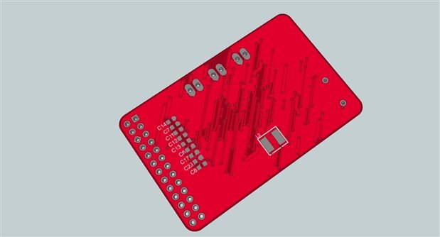

This new board is the same as the Qi Lime Pi Rev 2 but without the Prototyping area! I have made this smaller so costs will go down significantly and if one doesn't need the prototyping area, there is no reason to pay for the Prototyping area. image
These boards are on order and will be here the first part of December.

    Hey Chad,
    Do you use an autorouter, considering all your traces are diagonal? Also, you might want to look into board layout guidelines for switching converters. I guess the board will work as you designed it, but performance will not be optimal this way, probably more switching noise (both on the outputs and radiated) than necessary.  Especially routing GND and placement of input- and output caps can help a lot. Just to be sure: this is meant as positive feedback, maybe it helps in troubleshooting later on.
  • johnsocm
    johnsocm over 14 years ago in reply to DAB
    Thank You DAB! I wish I had more time to make it better but I had to get this on order so I still see lots of minor silk edits and traces I would change but I am more happy with the success of a working product and then work on how it looks later image
    I agree completely with you. I am a tinkerer like most of us so I will need the proto area to put on a few parts laying around the house like a Wifi or GPS chip or something. image
    Thank you again for the support!

    Hi Chad,
    You do good board design work.
    I agree with the keep it simple approach.  I think most people just need certain pins available to attach to their normal prototype board.  I know for my own uses, once the design works, the CAD work is usually fast and clean enough to go right to a PC board, so having a prototyping area with the board format is usually a wasted effort.
