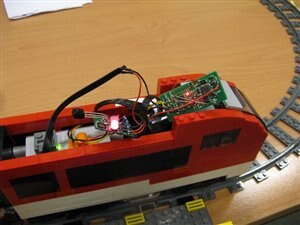

Qi LEGO Train
Now this is the part of the project that I was hoping to be able to finish when I started: making a Qi-charging LEGO train!
My purpose was to make a train that was able to charge itself when its batteries run low. When I was sure my LEGO charging circuit was working, I started combining it with my OpenPowerFunctions infrared receiver.

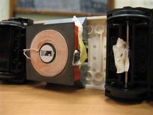

On this receiver I already had a microcontroller and motor control. In its original functionality, this infrared receiver just responds to commands sent by LEGO remotes, and then controls the appropriate motor driver channels to go forward or backward in the desired speed. I now added a resistor divider to the receiver to read out the voltage of the battery pack, and when that voltage is too low, the receiver ignores all incoming remote control commands, and starts driving to seek the charger coil.
Now how does it know when the charging coil is right under the receiver coil? This appeared to be a very difficult question to answer. The train runs quite slow when trying to discover the coil, but even then only a fraction of a second delay means the train passes by its target. The Qi receiver IC itself only enables its outputs after about a second of Qi connection, so that is too slow. I then thought of using the magnet in the charging coil in combination with a Hall sensor to signal to the microcontroller that a magnet had been detected. I soldered the Hall sensor, but even now the detection was not in time. The magnet was detected, but the inertia of a 3-wagon train was too large to stop in time. In the end I used tape and a spare magnet I had lying  around at Tkkrlab to give the receiver an earlier warning. This worked quite reliably. I could suggest two major improvements to the current setup:
  1. Use TI's multi-coil transmitter (bq500410a) to get a larger surface where the train can be charged. The positioning is now more sensitive than wished for.
  2. The 'low battery detection' is now based on battery voltage, whereas it should be on the availability of energy; when you start pulling a lot of current (stalling the train motor, or issuing a 'full on' command while the train is standing still) the voltage drops, and this is seen as 'battery empty'. When you leave the train on the rails, but do not ride the voltage will remain quite high for a long time. When the voltage drops below the treshold, the available charge is nihil. A fuel guage like BQ2060ABQ2060A will yield more reliable results in telling what the available State of Charge is.
Nevertheless: Great fun in building this system! Videos will follow....
Transmitter, battery pack, Qi charger, IR receiver
Train built together; IR receiver visible
Illustration of setup in action
Receiver coil, Hall sensor (with a lot of tape)
Transmitter coil in rails, with extra magnet for positioning
