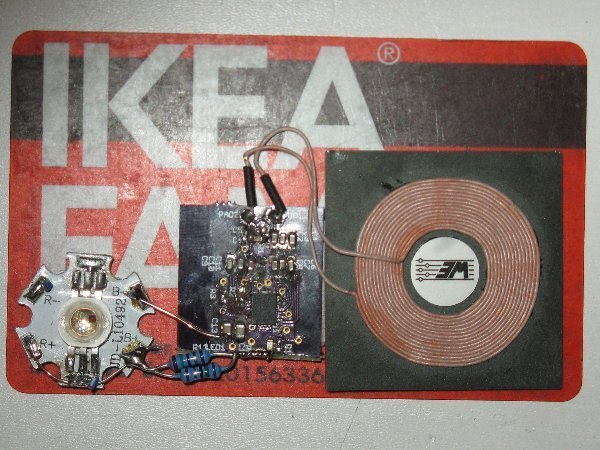

As you saw in the previous post I still have some boards left; I decided to do a real 'hack' to show how small you can make a Qi receiver. I soldered a Qi receiver circuit, and dremeled off the rest of the board. REAL PCB Hacking!
This setup worked, and I thought I'd make a QiLED (it's blue, so you could pronounce it as 'chilled' image )light. Another possibility to "integrate Qi in daily life".
The IKEA card (default credit card size) was added as a size reference; and look at how small the Qi receiver in itself can be! The width of the board is now 23mm, and it could even be trimmed a bit down if needed!

    Yeah, I like small circuits image I remember seeing a very compact 4-layer layout somewhere in a Qi brochure/app note, but can't find it now.  I found it amazing that this cost me about as much space as a diode bridge, 2 caps and a 7805; the 'standard' solution for a  5V supply!
    Regarding 'making' a small version: to fit the receiver in the LEGO battery box I had already made a very small design, for this 'hack' I just had to chopp off halve the board (a bit exciting, I did it after soldering the components. Should have done it the other way around!)...  Anyway, to me this opens up lots of possibilities for power in small housings.
