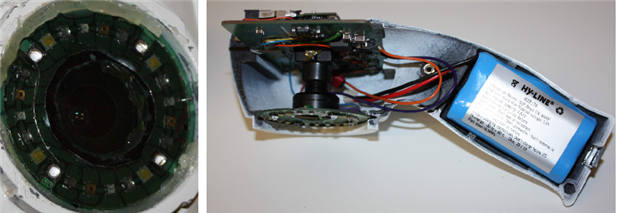

I implemented wireless charging of a prototype dermatology device "SkImager" (skin imager) that is useful in dermatology, oncology (skin cancer melanoma diagnostics), cosmetics, surgery, accident and burn treatment.This device was developed at the University of Latvia in Riga by the Biophotonics group lead by Prof. Janis Spigulis during EU project 2010-1013 and now is being tested by medical doctors: http://www.lu.lv/fileadmin/user_upload/lu_portal/projekti/es/2007-2013/eraf/optika/jul-nov2013.doc
It is based on Toradex NVIDIA Tegra 2 Computer Module - Colibri T20 powered by dual core 1 GHz Cortex A9 with 3 Mpixel CMOS digital camera and touchscreen interface and running WinCE.
Camera lens f=8 mm,  1/1.8" diameter, distortion 1.9%. Angle of view 58 deg. Multispectral illumination is done by LED ring at white, red 660nm, green 540nm and blue 450 nm wavelengths. Additionally, ultraviolet LEDs at 365 nm allow to induce fluorescence at longer wavelengths and infra-red LEDs at 940 nm allow to observe features not visible by eye. Crossed linear polariser technique is used to eliminate specular reflection from directly back-scattered light greatly enhancing image contrast.
Wireless charging is very attractive for medical devices because then they can be made hermetic and disinfected more easily. Contacts tend to wear with time, accumulate dust on them, oxidize. Cables break if bent too often or pulled harder and make a mess on the table.
