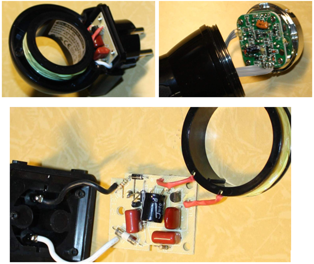

Curiosity was driving me to examine it inside.
Construction is held together with screws and hermetic seals made with rubber rings. Transmitter coil is driven in transformer-less circuit from 220 V. On the board is rectifier, 10uFx250V and a few other components. Coil has only 2 wires and is driven by something looking like a single transistor. A42 B331 written on it. Searched but could not find a datasheet. Probably it is something more smart. Because circuit has an automatic shut-down when flashlight is removed.

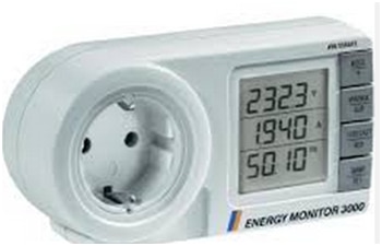

Let’s examine wallplug power efficiency with a Voltcraft Energy Monitor 3000.
We will measure active power dissipated. Device displays also reactive power that is tipically about two times higher, but we are not paying for it.

  • michaelkellett
    michaelkellett over 12 years ago +1
    The torch doesn't look to me as if it really shuts down at all when the load is removed. The small reduction in power drain may be simply due to the removal of the charging load increasing the impedance…
  • michaelkellett
    michaelkellett over 12 years ago in reply to janisalnis +1
    I'm not sure that adding load will help, if the internal resolution of current measuring is only 1mA that means a power resolution of no better than 0.23W with EU mains supplies. MK
    mcb1 over 12 years ago in reply to michaelkellett +1
    There are similar power meter devices sold over here, and they are way out. I suggest the only real way is to expose the mains through a small resistor on the neutral side, and measure the voltage across…
