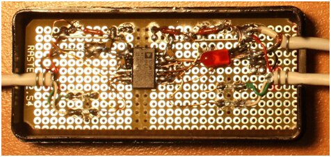

Analog Devices  ADuM4160 USB isolator
Analog Devices are producing a chip named ADuM4160 for USB galvanic isolation. It is working bidirectionally at low and full data rate 1.5 Mbps and 12Mbps isolating against up to 25 kV transients. Isolation is done by radio frequency transmission coupling.
This adapter chip ADuM4160 is transparent to PC and does not need any drivers. One can assemble adapter from a kit:
https://www.circuitsathome.com/adum4160-usb-isolator-assembly-guide
I am grateful to AD for sending me test samples. Below  you can see my version of the home made USB isolation adapter assembled with transformer wire on a prototyping board.

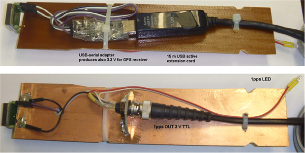

Below is a photo of a zero-budget GNSS receiver module with antenna model GNSS GLONASS GPS Engine Module GNS701 TTL MTK-3333 Navilock is providing NMEA messages via serial port and 1 pulse per second output. I placed it on the roof inside a plastic pipe. Metal sieve shields it from multipass reflections. It is in operation for half a year now. The system needs to run unatended around the clock and reliability is an important issue.

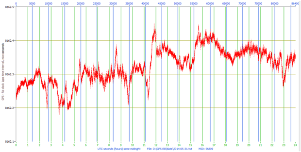

Below is a typical 1 day long plot of 1 pulse per second signal used to calibrate a Rb clock.
GPS receiver allows to calibrate rubidium (Rb) clock frequency drift within ca 100 ns. GPS timing on long term is the most precise as it is synchronized to worlds best clocks, but GPS signal can have bad days when solar activity causes larger deviations. And not only that. For example, on April 2 one could observe large jumps when GLONAS system was malfunctioning for a whole day due to uploaded wrong corrections to satellites. This topic was covered also in the news. Rb clock is operating all the time with less short-term noise than GPS, but is suffering from aging drift.

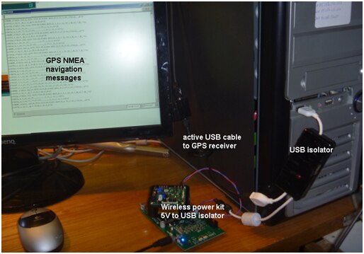

Picture above shows that it is possible to galvanically isolate the GNSS receiver and Qi Wireless Power Kit is producing enough power to supply the GNSS receiver with 5V. This modification did not influence GNSS data noise and scatter.
