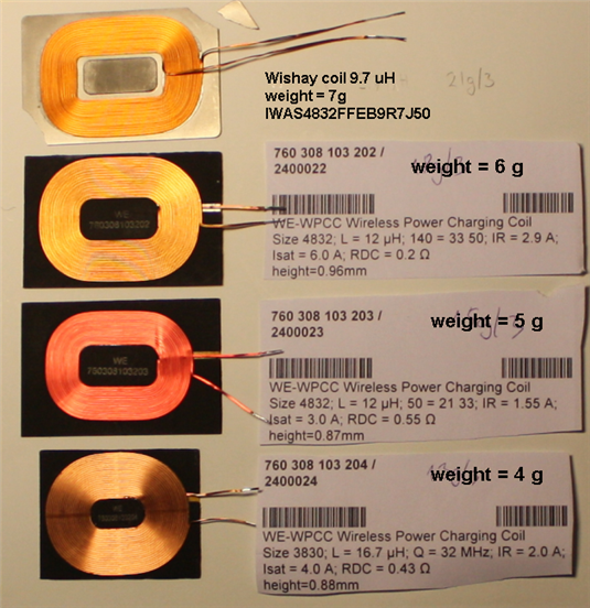

RX coils
I have ordered spare the RX coil from Wishay that was recommended in the TI RX chip datasheet and in the RX module could not read the coil part number as it was taped to plastic with part number facing down. Wurth Electronik pointed out that their coils are used in the EVK and were so kind and sent 3 types of their RX coils for free with an express delivery.
Receiver coils have a FERRITE plate that concentrates and shields magnetic field energy. Probably ferrite is chosen instead of metal because of smaller hysteresis loss and insensitivity to DC magnetic fields. The shield is brittle. We wanted to see if the coil could be bent slightly. That resulted in a broken corner. See the photo below.
I did not see weight specified in manufacturer datasheets. Weight is one of important parameters for portable electronics. For example a miniature toy helicopter weighing 20g would not be able to carry it during flight. I was curious to measure it. Wishay coil is the most heavy one weighing 7 grams. Smallest WE coil weight was 4 grams.
In Wishay coil central wire comes back and crosses the coil.This increases thickness to 1.5 mm. In mobile applications is often an  issue.
WE has engineered the central wire into a slit in a ferrrite shield making it a more thin construction. WE ferrite shield is slightly flexible. It could be probably softened by heating and bent into slightly round shape to fit cylindrical enclosure.
Wishay coil has 9.7 uH inductance, both larger WE coils have 12 uH and the smallest WE coil has 16.7 uH. Surprisingly, when I soldered them to the RX board, all of them worked and transfered power without necessity to change the capacitors on the RX board. This is good news for roadtesters. That we don't need to spend time for resoldering SMD capacitors.
Physics say that with different inductancies the resonance frequency should change. I think it works because RX and TX coils are strongly magnetically coupled so there is no individual resonance frequencies of each resonance contour, but, insterd,  it is one resonance frequency for the two-coil system. I connected oscilloscope and could clearly see that frequency is not fixed. It changes in small steps with load and coil separation. This is called in datasheet "Dynamic Effciency Scaling" and "Dynamic Rectifier Control"
Extremely clever system!!! Looks like the tiny chip is as smart as a microcontroller.This means that energy transfer is always optimal and devices that are being charged can have quite large manufacturing scatter.
