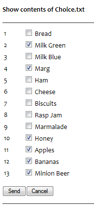

If you choose to alter the Shopping List
It runs the ShopList.php script, which pulls the data from Choice.txt.
This is a simple text file with a comma separator and 0 or 1 for items with a check against them.
The idea was you could arrange it in any order, and add items to it manually. ( I didn't have time to do something fancy for adding items ...)
Bread,0
Milk Green,1
Milk Blue,0
Marg,1
Ham,0
Cheese,0
Biscuits,0
Rasp Jam,0
Marmalade,0
Honey,1
Apples,1
Bananas,1
Minion Beer,1
The script numbers the entries and presents it in a simple form that allows you to click on the checkbox or the text.
Once you press Send, the form refreshes and shows the contents (mainly while I was putting this together), and writes the choices back to Choice.txt.
It then reloads the page after 2 seconds.
