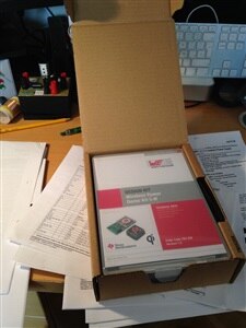

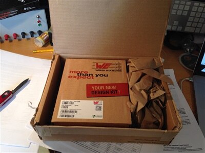

Yesterday morning I finally received my Demo Kit! Hurray!  Here are a few pictures of the kit and my first impressions:
When I started opening the packet it felt like a Matryoshka doll: a box inside a box inside a box! It certainly was well packed, maybe even too well.

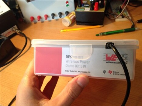

The final plastic case really got my attention. It is a nice transparent case. Once opened, we find the following content protected by foam:

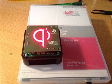

And I really like the detail that the case is also a part of the kit, allowing us to power the transmitter while inside. Therefore they have made a small cutoff on the front panel where the usb-cable can go through. On the top we find a drawing indicating where to place the receiver. Plug the adapter in and voila: the leds light up. It’s a nice detail that really increased the wow-effect when I showed it to my family.
A funny thing I noticed is that, while transmitting power, the kit makes noises. They are very soft and probably, if the whole thing was in a PCB not loud enough to be noticed. Nevertheless I would like to know the source of it and if it’s normal.  I have attached a small audio file to this post.  You might need to turn up your volume to hear it.
I already started taking some measurements and did some tests, but still without a clearly defined plan and it’s too early to draw any conclusions. More on testing next week!
    mcb1 over 12 years ago in reply to ForcisConnect
    filled with silicon
    Usually a small blob to join the two parts together is all they use.
    mark
  • ForcisConnect
    ForcisConnect over 12 years ago in reply to mcb1
    Yeah, it's more a curiosity than an issue. And I don't want my nice shiny EVM filled with silicon...not for now at least. image
  • hlipka
    hlipka over 12 years ago in reply to mcb1
    At least for me its barely audible, and the receiver will be inside of an enclosure. So I don't think that I need it (and I think Eduardo won't either).
    mcb1 over 12 years ago in reply to hlipka
    Not having my kit yet, but I wonder if you can add some silicon to 'glue' the two caps together.
    Normally its inductors that sing but it is High Frequency and quite short duration pulses.
  • hlipka
    hlipka over 12 years ago in reply to ForcisConnect
    Yes, it sounded like in your file. This seems to be the Qi back-channel - the receiver tells the transmitter its current status. Its called "backscatter communication" - basically the receiver creates a defined and pulsed load on the receiver coil, which can then be decoded by the transmitter. This should be 4 times per second, which matches what you see. See also the intro by Ti. It seems this places mechanical stress on the caps of the receiver board, which causes audible oscillations...
