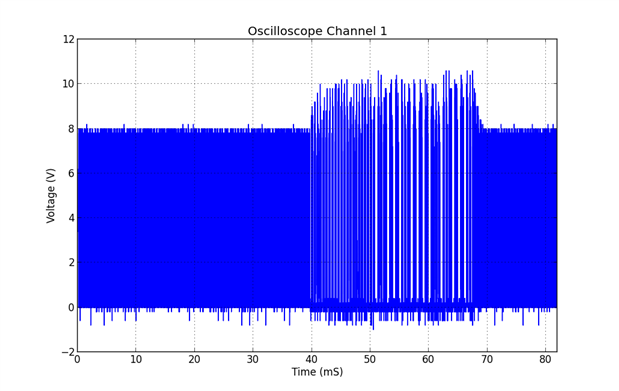

Lastly I wanted to further investigate the modulation of the AC coil. The datasheet states that the coil modulation is achieved with the COMM1 and COMM2 pins of the IC.
So I hooked up the probe to TP3 (COMM2) and got the following signal:
Fullscreen 4137.contentimage_52577.html Download
<html><head><title>Jive SBS</title></head>
<body><font face="arial,helvetica,sans-serif">
<b>Error</b><br><font size="-1">
An general error occurred while processing your request.
</font></font></body></html>
We can clearly identify a data packet being send.  A one is encoded as two transitions in 500us, while a zero is encoded as only one transition in the same time. This is called a differential bi-phase encoding scheme. For more information on it please refer to the datasheet of the IC or the specification of the Wireless Power Consortium, Part 6: Communications Interface
In the above picture we can count 21 “1”. This is the preamble of the message. The first zero (approximately in the middle) is the start bit of the header. After it, we receive two ones, followed by 6 zeros. These are the header bits, encoded LSB first (Value: 0x03) The next two ones are parity and stop bits of the header. After the header the message content is received: 1 zero start bit, 8 zeros message bits, and finally again two ones (parity and stop). This means the message content is 0x00. After the end of the message we still expect a checksum byte to be received, which is outside the screen capture on the right.
The next image is just to show how the COMM signal modulates the AC Coils Voltage Amplitude

I remembered having read something about controlling the Rigol oscilloscopes with Python from the computer at hackaday. And, after decoding the first packet by hand, I thought this would make a perfect occasion for trying it out and learning Python on the way.

So I copy-pasted the code from the first link and run it. As usually, nothing worked at first. Being a Mac user sometimes can really suck. (Only sometimes!). But I also found the appropriate tutorial on how to get my scope interface working with PyVisa. Instructions for it on the third link. After getting my scopes data nicely plotted on my screen the real work began, setting it up to capture the data packets and then trying to decode them.
I’m really sure there must be some standard way of demodulating a signal like this, or at least a proper technique. But as I’m neither an electronics engineer nor a programmer, I just started trying different approaches.
Fullscreen 6786.contentimage_52580.html Download

Fact is that, at the end, I got my scripts to decode the packets without (too much) trouble. The image above shows the blue data points from the captured signal and my decoded data in green. Next thing  was to set up the scope to capture sequences of data in order to see a “live” stream of packets.
This finally also worked, and I was able to see how the content of the message changed when I varied the load. Nevertheless I have always decoded the same 0x03 header, never a different one. Obviously I’m never going to get a message from the transmitter to the receiver, as I’m decoding the receiver’s signal modulator, but I expected to find other packets like identification or Signal Strength.
If someone has a Rigol scope (I own a DS1052E) and wants to try my scripts out I could certainly write a more detailed description on how to run them, how they work and so on. But I don’t want to bore all of you, so I’ll leave it out for now.
