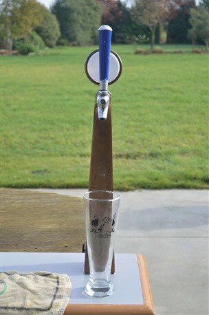

The second part of my challenge involved changing the illumination source in a genuine Beer Tap.
While it's not 100% practical (given that the tap has a connection to the amber liquid, as well as refrigeration pipes ... a couple of wires is nothing ), it does provide a basis for altering the plain lighting, and reducing maintenance.
                  Bar side or the important side                                                                                     Customer side

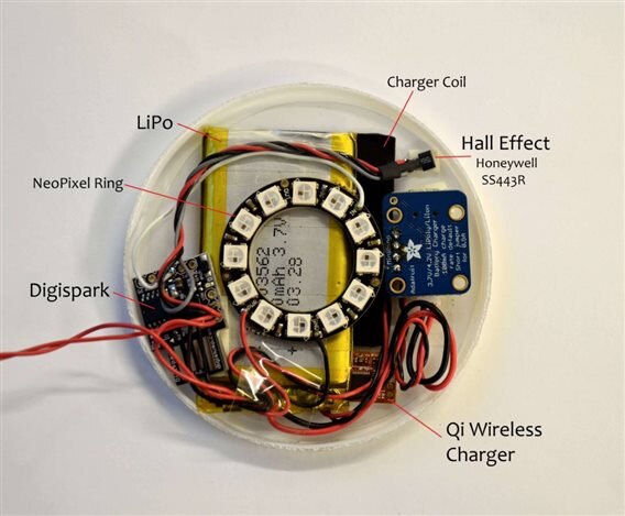

Charging
When I laid out the parts, I made sure the LiPo charger was 'face down' so the leds could be seen thru the disc.
I stuck everything onto a piece of mylar, so it could be assembled and adjusted easily (and just in case I slipped with the soldering iron, and damaged the disc).

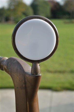

Operation
When first powered it presents a white (currently at 50% brightness).
If you pass a magnet over the Hall Effect sensor, it starts cycling through the various colors.
I have attached a video, showing just the disc (as the office is far too messy, and the lights not suitable)
This doesn't truly represent the colors as viewed by the eye, but gives an indication of the final product.
Parts
The parts are shown in this picture.
The wiring is very simple with the QI Charger connected to the 5v and GND of the liPo charger, the battery plugged in, and the Digispark wired across the BAT and GND connection points.
The NeoPixel Din connects to P2 and the Hall Effects output connects to P3 on the Digispark.
