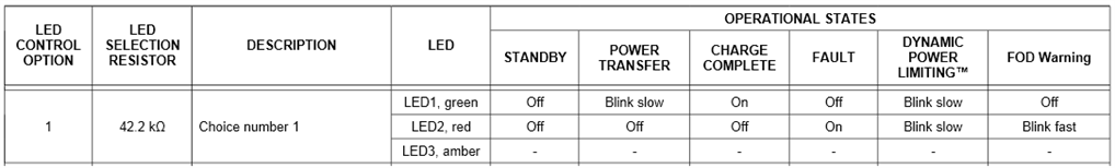

You need to seek the datasheet for the bq500212A and look on page 13, to find the table.
The standard value for R23 is 42.2k, which means it uses option 1.
I wish to avoid the flashing status, so I need to find another control option.

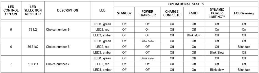

LED's
Part of Qi protocol is FOD detection, so I think it useful to warn the user and make it fairly clear by using the appropriate colour.
Despite having three LED's, IMO they aren't used very well.

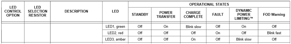

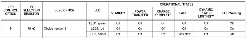

Control 5, 6 and 7 are the only options using all three LED's.
Control 5 uses the red LED for Power Transfer, FOD and Dynamic power limiting, yet it only Blinks the amber for a Fault. Green is only used when the charging is complete. (which could be a signal for GO).
Control 6 is better and uses the red LED to show a Fault, and Flashes for FOD. The green is flashed while transferring and solid when charge complete.
If only they made the amber solid when transferring, I could have used it.
Control 7 makes better use of the amber by indicating Fault, Power limiting and FOD. The red LED is used to signal Charge complete, but it flashes the green when transferring.
Apart from the flashing, it could have been useful.
My control would look like this
Green shows normal, Amber is a warning, and Red is a fault condition.
Short of reprogramming the chip, I have chosen to use Control 5 (but I reserve the right to swap the amber and red LED's)
