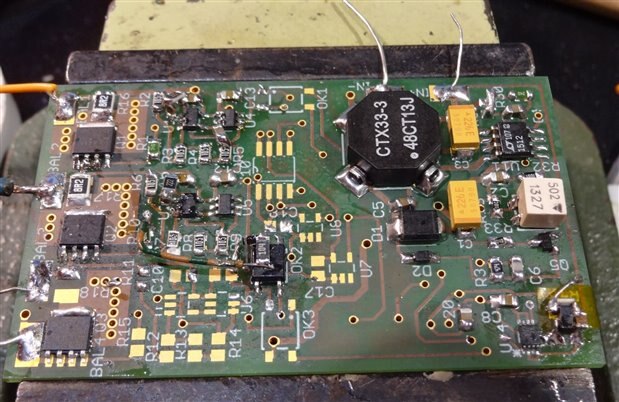

My plan for the last days was to populate one functional component after each other on the PCB, and verify that they work as intended. Sounds simple, but wasn't.

Next step was adding all the glue logic used for end-of-charge-handling. This area was rather crowded, so soldering was tricky. After managing that, when turning the circuit on again, I expected a power-on delay of about one second. But instead, I got - nothing. Now it got tricky. Sometimes it worked, sometimes not. So I attached the scope and the logic probes (fortunately the iMSO104 has both) to see whats happening. Turned out the reset circuit I designed won't work properly if the rise time of the supply voltage is too long. In that case, the reset signal would go to one even before the DFF starts working properly.
So I needed a much larger delay here. I measured the rise time for the wireless power receiver at about 1 ms. This is actually quite fast, but still to slow my idea to work. Since the set/reset signals don't accept slow-changing signals (the reason why I used such a short delay in the beginning), I added another AHC1G08 AND gate to handle that delay (the AHC series comes with schmitt-trigger inputs). Adding that one was tricky, and required serious dead-bugging. But after that, it worked as expected, without any hiccups.
(I count 4 bodges in this picture, and there will be some more...)
