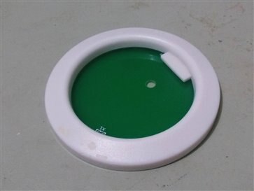

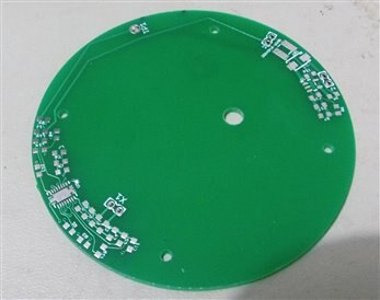

My circuit board arrived and quite pleased with the results. Since ordering the board there is a couple of design requirements that can be changed to either simplify the design but these are not important at this stage. All the screw hole fitted nicely owing to the accuracy of Eagle Cad although due to a small error on my behalf the holes where not wide enough. This is an easy fix although will impact on the PCB traces in a couple of areas. Although in the lower picture the right hand side and top small holes may cut into the trace image.
One of the main design constraint that I placed into the board to to completely isolate the Buck Converter to the Wireless receiver section. After testing I will see if there is any requirement for EMC and shielding if possible. Copper pores were not done in this PCB as I was not sure of the impact of a pore to induction in the magnetic field as the coil will be going directly under the PCB.

In this design I realised that I was going to need to make more boards to complete the design but at least if my soldering capabilities are good enough for such minute components, I should be able to get it working to look at any issues that I may not have thought of or factored into the design.
The board fits beautifully on the product ring which means there is no modification to the overall design of the board in this respect and as the components are so small it should be able to fit into the ring without issues. I still have a couple of components on order waiting to arrive but I should be able to start putting it together very soon.
