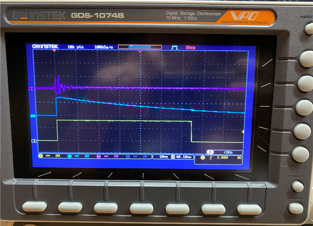

Blog Update 4/26/2021
Analog circuitry
Microphone to digital input
In this quick update, I'll post progress on the use of the op-amp. I realize that this was /actually/ my next step after the post up above. I really needed to get this finalized so I felt comfortable going on to the next step. I have a microphone that I need to use to detect a loud sound. To do this, I really wanted to use a digital input pin on the micro. I'm not trying to do any fancy voice detection or anything like that, just let me know if there is something loud. I knew that with the Op-Amp, I could both amplify the microphone's output signal up into the "volts" range (like ~1 to 3 V), and also convert it into a digital signal.
The design I worked out uses three stages of the op-amp. The first stage is a basic microphone pre-amp. The output of this is fed into the second stage as an analog signal. The trigger (inverting) voltage on the second stage is set at about 1V, and on the output I've used an R/C circuit to stretch the signal. The analog waveform that I was capturing was around 1-2 ms, and if read straight into a microcontroller could trigger the input multiple times for each 'sound' that I capture (again; not revealing what I'm building until I get farther along... image). So I'm using the R/C circuit to both debounce and stretch.
I then feed this into the third stage which serves like a comparator (same as second stage) but really to clean up the edges. The R/C circuit output signal is a sharp rising edge followed by a long decay. So using the last stage I can select the cutoff voltage within that decay (as my non-inverting input) and have a nice clean digital on/off signal come out the other side which is now about 65 ms long and much easier (trivial) to read on a digital pin.
This is /by far/ the most analog circuitry I've really ever done, and first time not following a boilerplate example. I basically took the building blocks I knew and starting stringing them together. I knew that I could use the op-amp to amplify a microphone. I knew that I could use an R/C circuit to make a time-constant. I knew how a comparator worked. Just had to smush them all into one complete circuit. Initially I struggled with the R/C portion of the middle since I wasn't getting the delays I wanted. There were a few different ways of doing this with different components (like a common transistor) but I really wanted to use the op-amp. I finally realized looking at my schematic and also this post from EE Stack Exchange that I could use a diode to feed the R/C circuit. It took a while since they are doing different things in that circuit than I am and I had to sort out what each part was doing. By adding that in-between stages, it lets the voltage at the top of the RC circuit come up essentially immediately to the right level, then fall according to the logarithmic time constant. I think what happens without this diode is that the voltage back-feeds through the op-amp to ground, and it cancels out the bleeder resistor. (someone please correct me if I'm wrong on that assumption). Either way; the instant I added this, I got a beautiful clean R/C decay with 'instant on'. This fed into my last stage and I now have a clean digital signal for the microcontroller.
Photo interrupter
I know this was mentioned above, but I also am putting it here since I have a complete circuit digram to share. I'm debating making a board for this, but have to find or create basically all components into my Fusion (eagle) library and not sure I'll have time to do that, create the board, and get it here and assembled before the deadline.
As noted above, this gives a voltage swing from 0 to about 2.7-2.8 volts. To ensure this is cleanly read by the Arduino MKR, I used one section of the op-amp as a comparator. This also means that I've neatly used all four sections of the op-amp image. The data sheets notes to not let pins float if unused, but I don't have to worry about that now.
{gallery} Analog Circuits
A mess of wires: Scoping the various stages in the microphone circuit.
Analog Schematic: schematic of the analog signal processing and conditioning.
Clean digital output: This is the three stages of the circuit. Top trace is the raw analog; middle trace is the RC decay, third stage is the clean digital sigal with the pulse stretched out.
Mistake circuit layout: This is the trace I kept getting when trying to work on the R/C circuit without the diode. I was getting digital signals out the end, but without having the diode, I got no benefit from the R/C circuit and the signal was very noisy. Would have been a pain to debounce in software.
Don's Sneeze!: Had to be super careful working around this mess! A few times, I'd hook the probes on the wrong wire and wonder what I had done to ruin the design...
That's it for this post. Let me know if you have any questions image or how I could have done this better. I stopped short of just looking up a "The Clapper" circuit since I wanted to figure it out myself a little bit. This way I've learned more about R/C circuits and how op-amps work.
